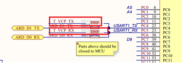

Andrew Neil
Before adding the complications of printf, have you got it working with a basic blocking HAL_UART_Transmit ?
Use this to prove basic connectivity.
Use ST's example specifically for the NUCLEO-G474RE.
@mpek29 wrote:
the data isn't hitting the ST-Link.
How did you test that?
If it is the case, it means you are using the wrong pins for your UART - which is a common mistake.
You must use whichever pins from the STM32 are physically connected to the ST-Link's VCP pins. - other pins will not work
To find which pins those are, see the board's User Manual and/or Schematics.

How are you using USART2? are you using a USB to UART converter? if yes how?
Are you aware that you can use the virtual comport over USART1 over STLINK on this board? but for that you need to solder SB12 and SB20 as they are not connected by default on the hardware.
I usually interface with my NUCLEO-H723ZG via the micro-USB port, utilizing the ST-Link Virtual COM port identified in the Device Manager (which maps to UART3 by default). I've gathered that it’s possible to achieve the same functionality using UART2 instead for the NUCLEO-G474RE. Given that a friend is successfully doing this on the same hardware without physical modifications.
Each board has its own hardware configuration. On NUCLEO-H723, the VCP is connected to USART3 while on NUCLEO-G474RE, VCP is connected to USART1 and you should solder SB12 and SB20 as I stated previously.

Again, the place to look is the User Manual and/or the board scheematics:
https://www.st.com/resource/en/user_manual/um2505-stm32g4-nucleo64-boards-mb1367-stmicroelectronics.pdf#page=24
