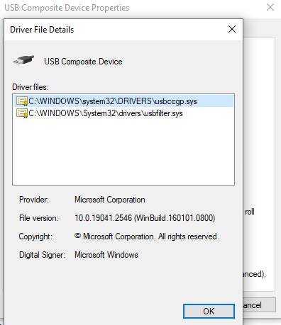

0693W00000aJ8ESQA0.pngI checked the drivers and the device is showing as a USB Composit Device and I have no alternative to change the driver.
I installed en.stsw-link009 and successfully installed some drivers but they are not available in device manager.
I uninstalled the device in device manager but still no change.

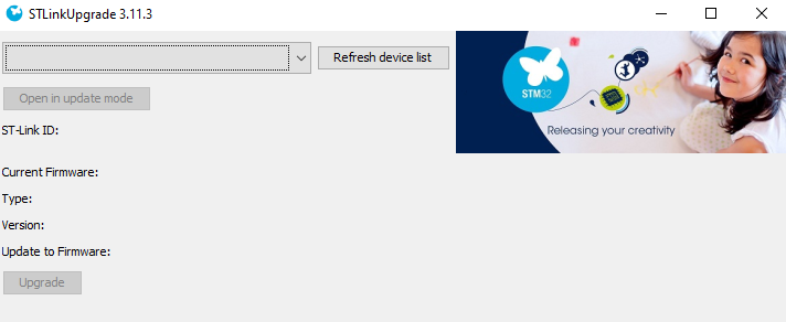

OK, please try to upgrade the embedded ST-LINK/V2-1 using STM32CubeIDE and the command:
Help > ST-Link Upgrade
It doesn't recognise the ST-LINK/V2-1

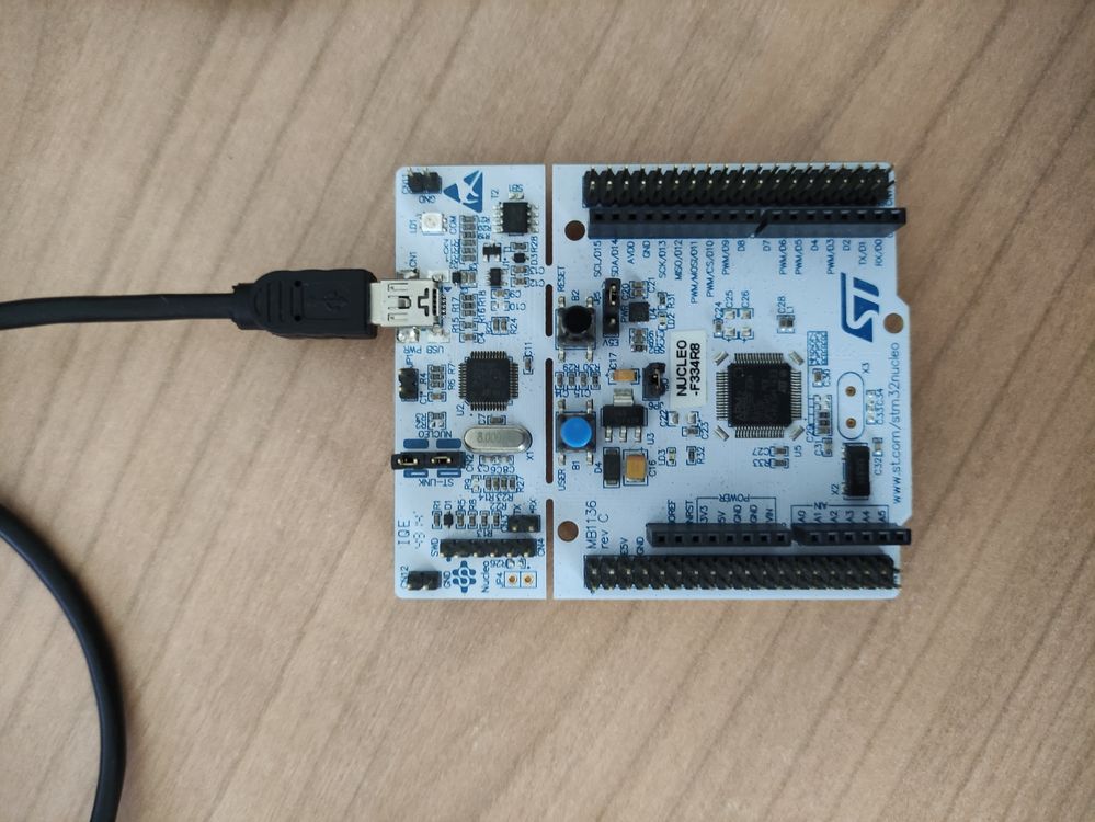

Peter BENSCH
The ST-LINK/V2-1 cannot be recognised because it does not receive any supply voltage.
Please set a jumper on JP1 (directly next to the MiniUSB socket).
Regards
/Peter

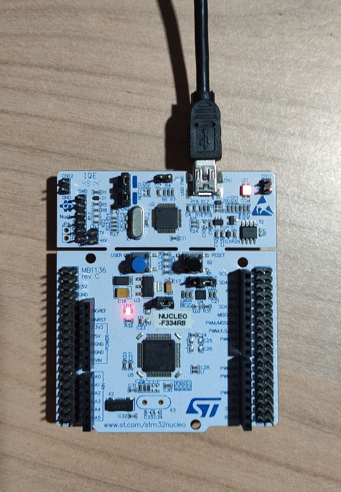

0693W00000aJ8RCQA0.jpgI don't have an extra one right now.
I recieved this device from somebody and it already has some jumpers:
  • 2 on the two gnd connections on the bottom
  • 1 in IDD
  • 2 in CN2 - it says st-link on the side
  • and 1 in PWR
can I remove any of these?
The two GND jumpers at the bottom are spare ones, your can easily take any of them.

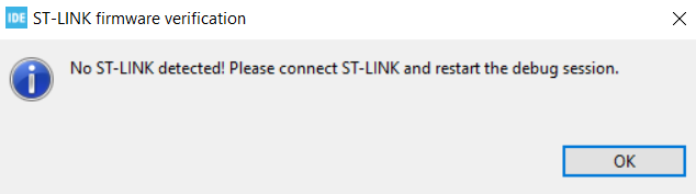

still nothing
I restarted the IDE and reconnected the board
after reboot still the same, drivers also the same0693W00000aJ8X5QAK.png0693W00000aJ8XKQA0.png
