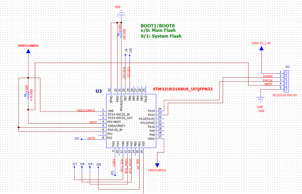

I made a IOT prototype with STM32U031K8T6, but I can't download firmware.
The connection isn't working ad it should, can anyone tell me the issues with the attacked circuit ??

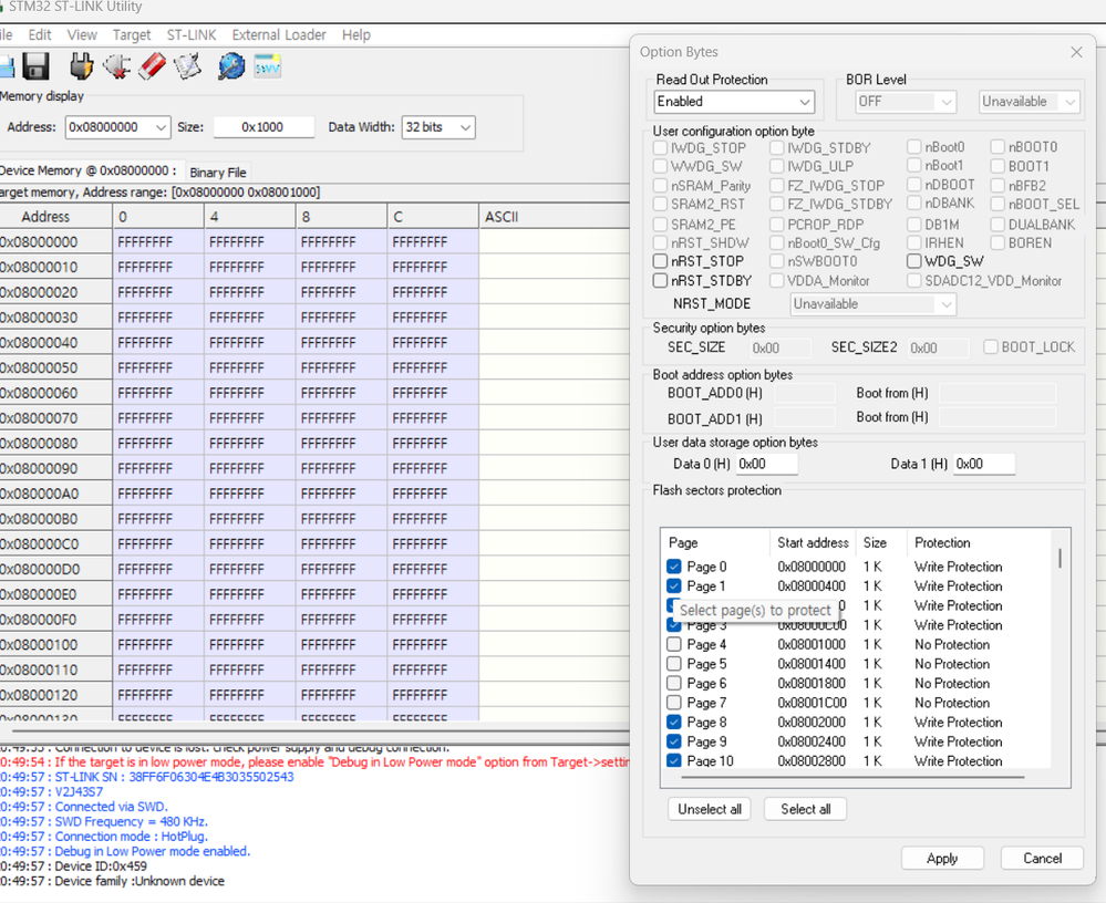

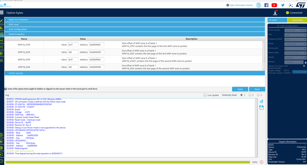

STM32U031K8U6  SWD Download fail
"Write protection is enabled."
"IC purchased from Digi-Key"
"Unable to download after compiling in STM32CubeIDE."
"The connection frequently drops in STM32CubeProgrammer."
SWD 5PIN: +3.3V, SWDIO, SWCLK, NRST, GND

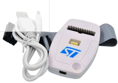

st VLINK V2
"The STM32F469 is working properly using the ST-LINK V2."
"After purchasing from Digi-Key and connecting with ST-Link Utility, I found that it is write-protected."
You posted a screenshot of the ST-LINK/V2 from the website, but I asked for a photo of the front and back of the ST-LINK/V2 in front of you.
The ST-LINK Utility is long outdated and no longer works with newer MCUs such as the STM32U.

STm32U031F8U6 ST-Vlink/V2 Download fail  Solve.
SWCLK: 68pF (Pull-down, 1608 MLCC)
Delete Noise.
add info
SWDIO: 10pF (Pull-down, 1608 MLCC)
NRST: 100nF (Pull-down, 1608 MLCC),  NC-4.7K (Pull-up 1608)
