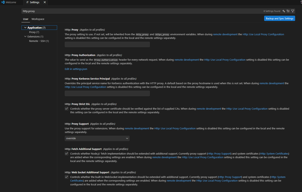

Hi @Julien D,
With the version >1.2.0 the issue is systematic and consistent, I am not able to reach the st server at all. Using version 1.1.0 and below we have a random loss of connection (most of the time it can reach the server, but sometimes it can't).
Are you behind a proxy?
If not please ensure that you don't have anything defined into your http.proxy vscode settings.
If so try to remove any http.proxyAuthorization and restart vscode.
No, not behind a proxy.
This is the vscode config:Screenshot 2026-03-25 094422.pngAnd in the settings.json I have
"http.proxyAuthorization": null
