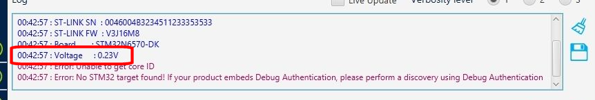

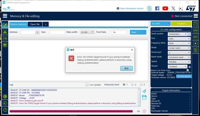

STM32N6570-DK,Unable to connect using STM32CubeProgrammer software ST-LINK, target not found
peak
STM32N6570-DK STM32CubeProgrammer,Unable to connect using STM32CubeProgrammer software ST-LINK, target not found,Error: No STM32 target found! lf your product embedsDebug Authentication, please perform a discovery usingDebug Authentication
How to solve it

Target Voltage: 0.23 V
This is insufficient voltage to power the device. Look at the user manual for how to power the device properly.
Andrew Neil
As @TDK said, you have no power on your target:

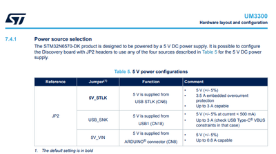

Hello, how to set the voltage? I don’t understand the manual. How much voltage is needed to be adjusted to connect to ST-LINK normally
peak
Hello, how do you need to restore normal operation? I don’t understand the manual very well. Is there any specific method? thank you

I doubt it's a matter of "setting" or adjusting the voltage.
This almost certainly means that the Target is just getting no power at all.
You need to study the User Manual - there is usually a section describing its power supply options.
You could also look at the schematics ...

Hi @peak
I'm refering to STM32N657-DK UM3300 in Figure 4. STM32N6570-DK PCB layout top view.
https://www.st.com/resource/en/user_manual/um3300-discovery-kit-with-stm32n657x0-mcu-stmicroelectronics.pdf
Could you confirm the following steps below:
1) Put the STM32N6 is in DEV_BOOT, meaning BOOT0(SW2)=L (GND) and BOOT1(SW1)=H (3.3V)
Refer to the Figure 4, BOOT0 must be set to the inner of the board, BOOT must be to the outer edge of the board.
2) Connect a data USB-C cable on CN6, check that you are not using a cheap charging USB cable. You need a data USB cable.
3) Press RESET button (black button)
4) The LED red (LD2) must be on. That's means the N6 is in DEV_BOOT.
5) In STM32CubeProgrammer refresh the STLink version using the arrow that turns next to the Serial Number icon.
6)  Change STLink Mode as Hotplug and Access port = 1, then click Connect
Let me know if it solves your issue?
