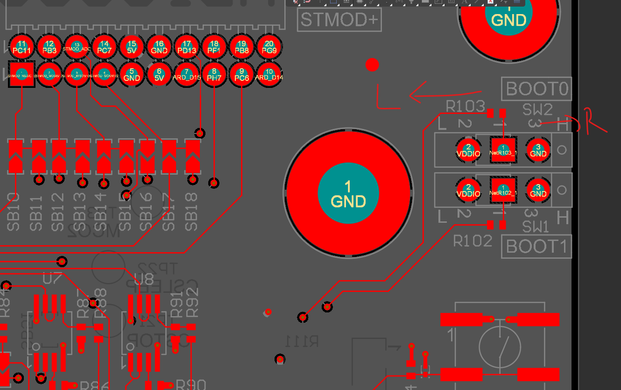

Hello, I have the STM32N6570-DK kit. I can compile, upload and debug by following the instructions on the kit. I designed my own board but I can't debug. I'm reviewing all the possibilities and I noticed some problems. I couldn't find any explanation.
https://community.st.com/t5/stm32-mcus/stm32n6-boot-rom-explained/ta-p/763648
@B.Montanari 's article says H(High) VDDIO. However, in the DK schematics and pcb, the left side is vddio and the right side is gnd. Also, the Boot1 pin is pulled to the right to load software on the DK. So Boot0 becomes important. What's the problem? Are the documents wrong? Also, on the board I made, I can load software when boot1 is connected to vddio. But on the DK, it allows me to load software when boot1 is GND. What's the explanation?

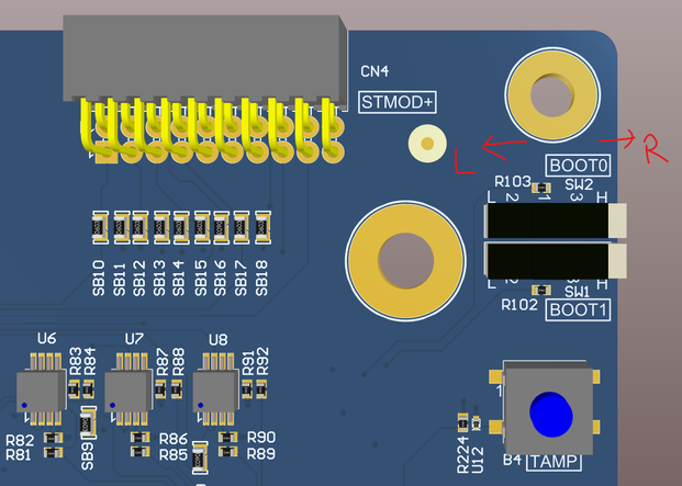

Hi @Okeskin
This is because on this SPDT DIP switch with common input, the closing direction of the internal contact is reversed compared to the position.
When SW1 or SW2 are in Right position (H), the contact is between 1 & 2. The BOOTn pin = VDDIO.
When SW1 or SW2 are in Left position (L), the contact is between 1 & 3. The BOOTn pin = GND.

‎2025-06-24 11:56 PM
Hi @RomainR.
If you examine the MB1939 project files and the pictures I shared below, you can see that pulling the switches to the right means pulling them to gnd. I can already work on DK without any problems. The problem is that in DK hardware, pulling to the right should be High, but it is actually Low. Please examine MB1939.

‎2025-06-25 2:54 AM
Hi @RomainR.
I didn't think that switch was working in reverse. Thank you for the information. It's more clear now.
