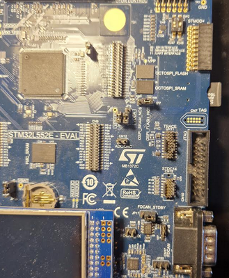

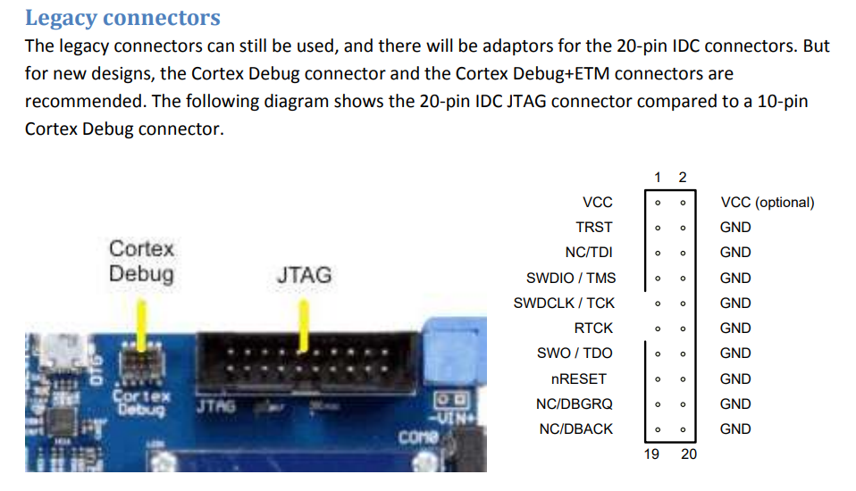

I have a evaluation board STM32L552E-EVAL and I would like the know how to connect the JLINK (EDU) to this board ? According to the instructions I see this connector which could possibly connect with the JLINK
Thank you for your helps.

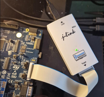

For the 2 connectors it is compatible. Now how to compile a program and do DEBUG with JLINK ? To have a lot of the documentation or the link is very good but now how to work with the SEGGER ?

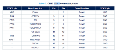

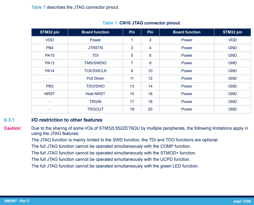

Yes, that would be the correct connector.
See also Tables 6 & 7 in the User Manual.
It matches the standard ARM pinout:
https://documentation-service.arm.com/static/5fce6c49e167456a35b36af1#page=3
Your J-Link documentation will tell you the pinout of your J-Link - it should cover the standard ARM pinout...

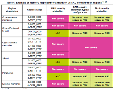

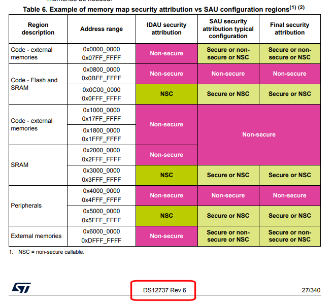

‎2024-10-04 6:00 AM
I don't have the same board (Cortex Debug # CN7 TAG)

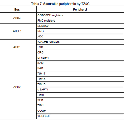

For the Tab 6 and 7 in the User Manual, I don't know what you're talking about I have this one :

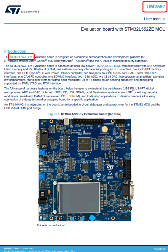

Are you sure it's an STM32L552E-EVAL card ?
‎2024-10-04 6:12 AM
@DYann.1 wrote:Are you sure it's an STM32L552E-EVAL card ?
Yes:
Note that the picture I posted in my previous post is from an ARM document - not ST - illustrating the ARM standard pinout.

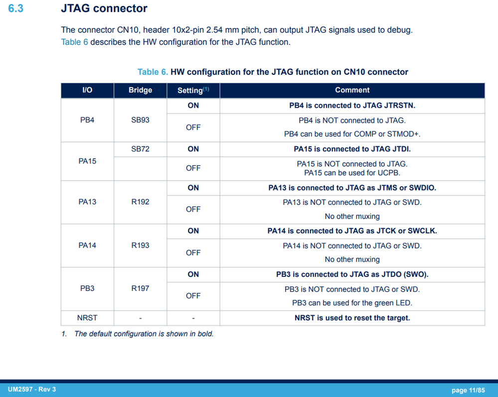

‎2024-10-04 6:17 AM
@DYann.1 wrote:For the Tab 6 and 7 in the User Manual, I don't know what you're talking about I have this one :
That's from the chip's datasheet - not the board's User manual:
‎2024-10-04 6:21 AM

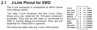

Thak you about CN10 JTAG but I have this connector on the JLINK side, I think I can plug it directly (it's intended for I think)

@DYann.1 wrote:I have this connector on the JLINK side, I think I can plug it directly (it's intended for I think)
Probably.
Again, check the J-Link documentation to be sure.
https://www.segger.com/products/debug-probes/j-link/technology/interface-description/

‎2024-10-04 7:30 AM - edited ‎2024-10-04 7:31 AM
‎2024-10-04 7:51 AM
@DYann.1 wrote:For the 2 connectors it is compatible. Now how to compile a program and do DEBUG with JLINK ? To have a lot of the documentation or the link is very good but now how to work with the SEGGER ?
Good - so that answers the original question?
