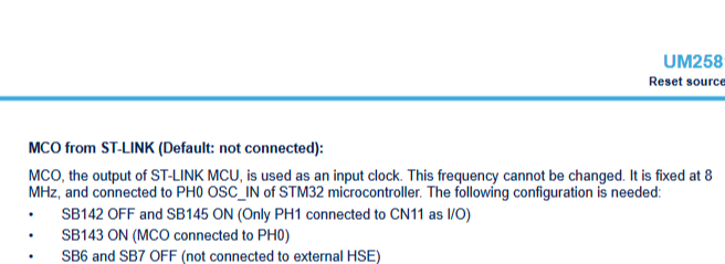

@krook wrote:
 it is not clear to me from reading the user manual from where I can fetch ST-LINK MCO. What physical modifications do I need to do?

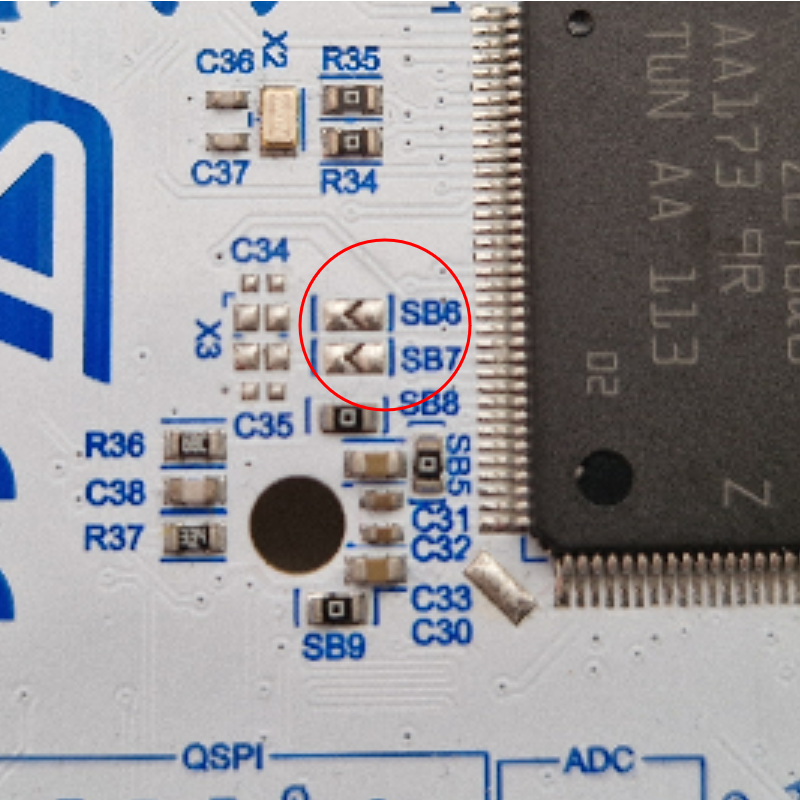

From the extract @Chris21 posted, these are the settings you need:
"Off" means that there is no connection across the solder bridge - the bridge is open;
"On" means that there is a connection across the solder bridge - the bridge is closed.
(look like they forgot that this is just a solder bridge and not a jumper link - where the jumper would be literally on the pins, or off them)

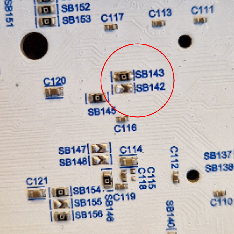

I am primarily a software developer, but your short and concise comments made it clearer. Looking at my board (to verify what is written in the document), it indeed appears as if the configuration is not correct to do what I want.sb1.pngsb2.png
I gather that if I manage to move the resistor from SB142 to SB143, the hardware should be correctly configured, and I can access the clock by manipulating registers, i.e through software.

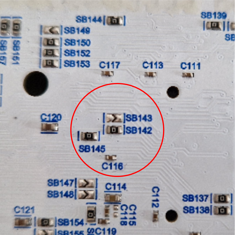

I've made the necessary changes, and turn on SB143 while I've turned off SB142. However, I must have done something wrong as the HSERDY bit still never is set. Hopefully the error now is simply a software error. The code I am using to try and use the ST-LINK MCO follows
RCC->CR |= RCC_CR_HSEBYP_Msk | RCC_CR_HSEON_Msk;
while(!(RCC->CR & RCC_CR_HSERDY_Msk));
Here is a picture of my modified board
Any idea what my likely error is now? I can't remember what, but something gave me the impression that the ST-LINK MCO would appear as HSE. @Andrew Neil @Chris21

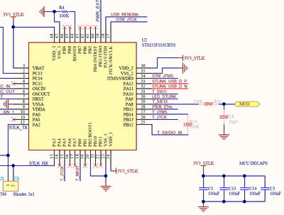

It looks like you have done the correct things with the hardware and software.

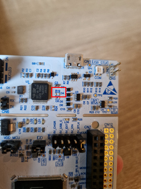

I wonder about R19 on the ST-LINK:
It looks like that would need to be present.
@Chris21, that does indeed seem relevant. May I ask where you found this diagram? For my own future reference in trying to figure these things out.
When I look at my board, there is indeed what I interpret as an OFF solder bridge there. I believe that I should put another 0-Ohm resistor there to make the current be able to pass. This was less obvious to me as R19 was not mentioned in the two documents I looked in. It makes sense that this detail should be found in the ST-LINK documentation, but I only considered that my STM-board was misconfigured.

The schematic for the board is on ST's web site: https://www.st.com/en/evaluation-tools/nucleo-l552ze-q.html, click on the CAD resources tab.
100R denotes a 100 ohm resistor, but 0 ohms (or a bit of solder) should work.
