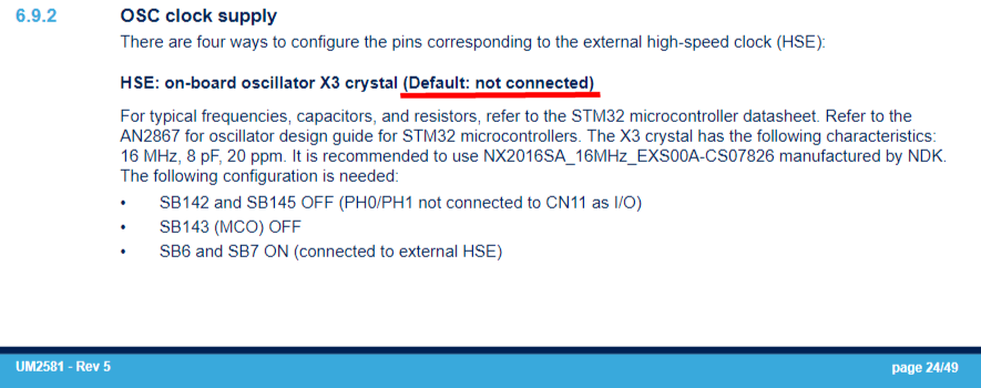

Hi, I am trying to program a STM32L552ZEQ to use HSE instead of the default clock, but I am doing something wrong.
I attach the reference manual, as well as the user manual for my specific board. In the user manual, on page 24, it is stated that there is a HSE with 16 MHz clock frequency. I try to enable this by setting the HSEBYP and HSEON bits in `RCC->CR`, like so

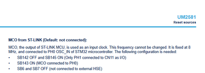

In the user manual, on page 24, it is stated that there is a HSE with 16 MHz clock frequency. .
It also states that, by default, this is not implemented:
So have you made the necessary hardware changes?

I would connect the solder bridges to use the 8 MHz MCO from the ST-LINK.
Andrew Neil
October 10, 2024
I think the default hardware configuration should be that the solder bridges are set for the 8MHz MCO from the ST-Link?
Correction: UM says it isn't (credit @Chris21 )
