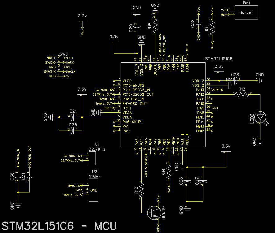

I've attached the schematic for my circuit design.
I really appreciate your prompt help guys to facilitate this issue.

Hello alharthi.waleed,
I'm using the ST-Link/V2 myself on a custom PCB and it works fine.
Your SWD setup looks correct except for one part that makes me suspicious:
VDD->Vcc
The SWD interface does not provide means to power the MCU, but it does take the MCU VDD as an input
You need to provide a power supply for the MCU from elsewhere (as you wrote, you use a battery).
Not sure what Vcc voltage is since you run it over a resistor, but the SWD VDD should be connected directly to the MCU VDD (3V3).

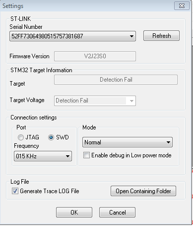

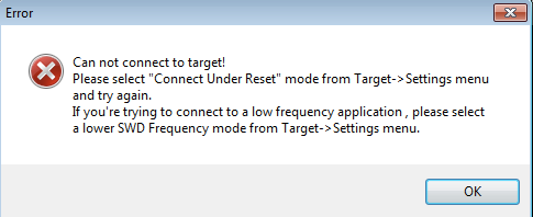

I've checked the power and it's fine there is no drop in voltages however once I tried to connect with STM32 ST-LINK Utility with the below configurations:
I got below error message:

Without seeing your schematics, guessing you don't have the supplies connected correctly. Check VDDA, and scope what NRST is doing.
