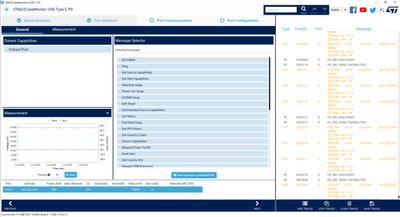

After plugging in my STUSB4500 sink board, there is no negotiation completed. The source is able to send out it's power delivery capabilities, but no messages are received from the sink in the traces of STM32CubeMonitor.
OUT	471419	0	SOP	 PD3	s:010	    H:0x27A1    	(id:3, DR:DFP, PR:SRC) 	SRC_CAPABILITIES	DATA: 0A9001002C410600

On the oscilloscope, the sink board gets a 20V spike that then decreases since the power delivery negotiation never finishes.
I do not think  this is a sink issue as connecting the sink to a USB-C Dewalt charging power brick that delivers 65W can provide a sustained 20V after 5V. The negotiation seems to complete itself.

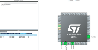

Software Setup:
I've followed the USB PD wiki closely (https://wiki.st.com/stm32mcu/wiki/STM32StepByStep:Getting_started_with_USB-Power_Delivery_Source) and made an STM32 project using the STM Cube IDE (https://github.com/michaellu2019/STM32G0_USBPD_Source) for the Nucleo G0B1RE board. I've downloaded the STM32 Cube Monitor to see debug logs. I have also tested uploading a completed binary (https://github.com/STMicroelectronics/x-cube-tcpp/blob/main/Projects/NUCLEO-G474RE/Applications/USB_PD/SRC1M1_Source/Binary/G4_SRC1M1_Source.bin) to my Nucleo-G474RE to cross check my software, but run into the same issue of no sink communication. The Sparkfun STUSB4500 board has been configured to receive 20V 3000mA, which is one of the listed PD options in the SRC1M1.

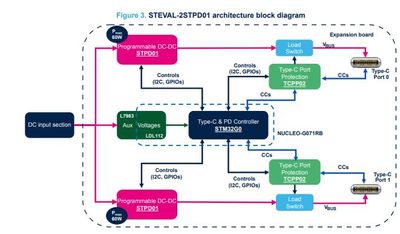

STEVAL-2TPD01USB Type-C Power Delivery dual port adapter based on programmable buck converter (60W for each port), documentation is available on web on documentation tab. User manual details technical behavior while the Quick Start Guide provides a kit overview + basic setup & programming.
Below, documentation extract shows architecture block diagram with main part numbers to performs key functions (DC/DCs, MCU, HV interfaces and protections) and links between them.
SW and HW resources are also available.
