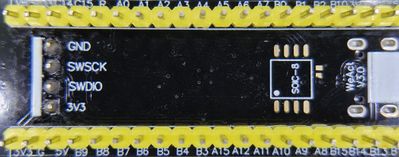

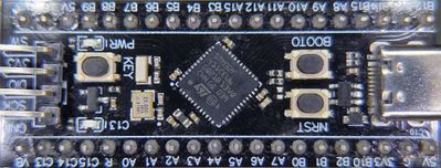

Board: WeAct BlackPill V3.0, MCU: F411CEU6 (original), SWDIO and SWCLK correctly configured on pins PA13 and PA14 (SWD configuration), target voltage 3.28V.

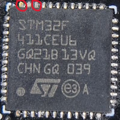

Some time ago, after checking the board, I noticed two pads not soldered correctly, coincidentally they were pin 36 (VDD) and pin 34 (PA13 of the UFQFPN48 package); but I left the hardware work as a last try, being the most risky.
Having considered all possible causes of malfunction not strictly hardware-related I decided to check this case too, trying to add solder where it was missing.

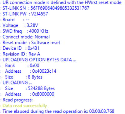

After adding it... surprise! it works flawlessly in every mode.
Seems that it was just a faulty solder, despite it being an original WeAct BlackPill.

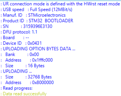

When connected via USB with DFU mode selected (BOOT0=HIGH) it's shown as "STM32 BOOTLOADER", a serial number is recognized too.

3V3 to Pin 1 (of 20-pin header)
GND to Pin 4 (or other EVEN GND pins)
SWCLK to Pin 9
SWDIO to Pin 7
Double check connectivity too PA13/PA14

As mentioned in the first post, DFU works perfectly and i can use the BlackPill in this way.
