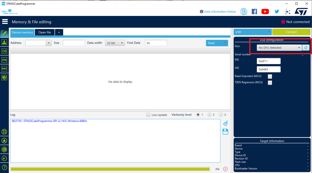

I am new to STM products. I have a STM32F407G-DISC1 board and would like to demo a flash program update over USB. I am using the STM32CubeProgrammer.
I am using the following to set up the board for DFU: STM32F407G-DISC1/STM32F4DISCOVERY DFU mode · GitHub
Below is a picture of the board with the connections:
When I open the STM32CubeProgrammer it shows DFU not detected.
Any insight as to what I am doing wrong?
Thanks,
Brent

Check NRST solder bridge between ST-LINK and F407 is disconnected.
Perhaps also power the North USB connector, you want the 8 MHz MCO clock from the ST-LINK for the F4 USB to function

Hello @BAW ,
Could you please refer to How can I use STM32CubeProgrammer to access the US... - STMicroelectronics Community  and check your hardware connection.
I hope this help you to solve the issue.

Thank you both for the information and suggestions.
Looking in the AN2606 Application note, I needed Pattern 1 to activate the bootloader.
I needed to pull Boot1 to ground. Before I was only jumping Boot0 to VCC.
Thanks again for the help.
