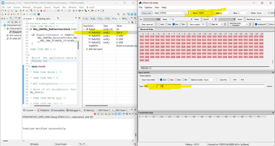

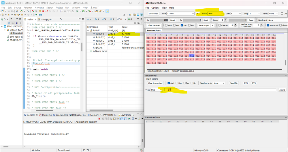

1. Setting baud rate 9600 HTerm is working

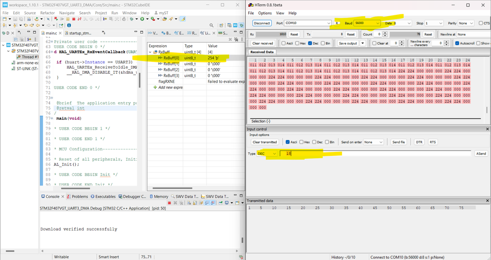

2. Setting baud rate 56000 HTerm is working

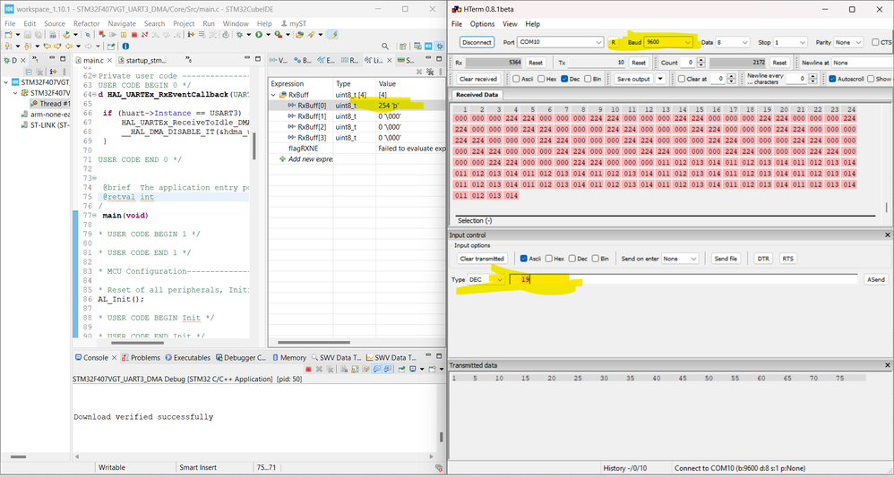

3. Setting came back  baud rate 9600 HTerm is not working

waclawek.jan
> then i change baud rate 9600 can not receive
How do you change baud rate?
Read out content of UART registers for "working" and "not working" cases, and compare/post.

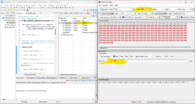

Tato
