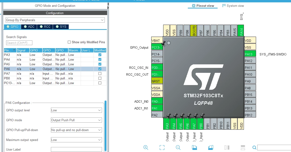

I configured GPIO pin 6 as Clock output for the HX711 but when calling HAL_GPIO_WritePin the output pin PA6 does not change.
The hardware configuration is set in CubeMX .

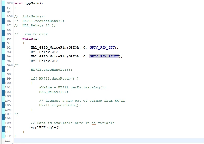

I reduced the code to only couple of lines ...

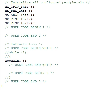

I am writing code in C++ so I have a call of appMainC() that is declared as "extern C" as main() for my code. This may not influence our issue but I added it just for clarity.

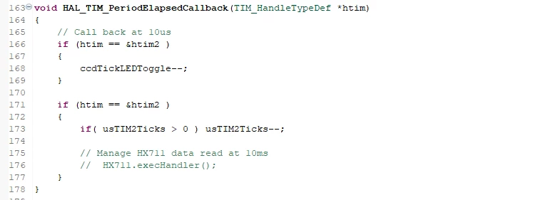

And I also have the timer ElapsedCallback function call ..

The pin is conflicted?
The pin you're probing isn't the one you think it is?
Check registers at a peripheral level, that the GPIO bank clock is enabled, that the pins are properly configured. Dig deeper into the code that's actually doing the configuration, the top level code is superficial

Read out and check/post content of GPIOA registers.
