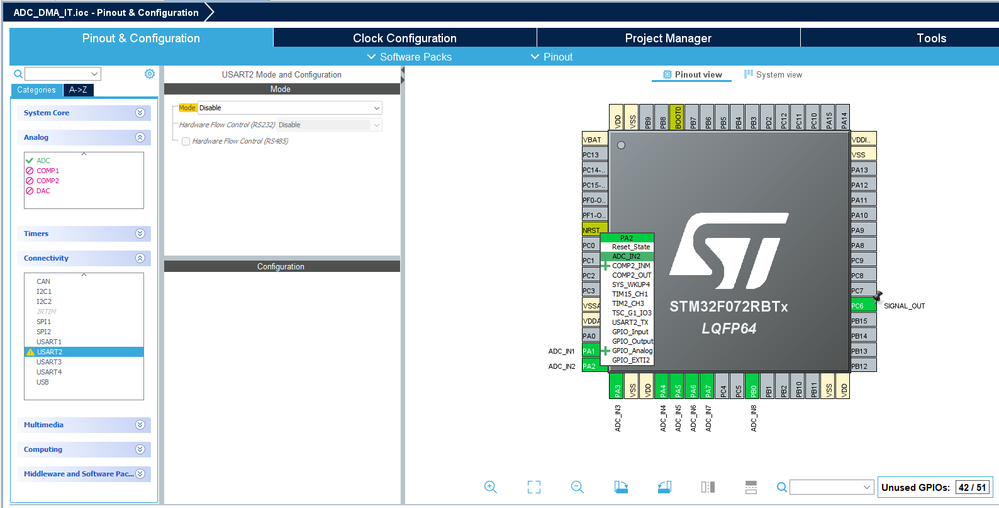

Hi, I need to read 8 channels through the ADC in DMA circular mode, to check the channel status readd I put all channel to GND from nucleo board and two channels (ADC_IN2 on PA2 pin and ADC_IN3 on PA3 pin ) doesn't give me the correct data, you can see in the image all channels to 0 except this two.
I try change the wires but isn't the problem.
All code is generated from MX tool.
Can anyone tell me why these two channels are not working?
Attached is the entire project.

2025-04-23 7:53 AM
it seems to me that ADC doesn´t work right. Try to set these parameters in CubeMX or directly in CubeIDE :
hadc.Init.ContinuousConvMode = DISABLE;
hadc.Init.ExternalTrigConv = ADC1_2_EXTERNALTRIG_T3_TRGO;
sMasterConfig.MasterOutputTrigger = TIM_TRGO_UPDATE;
