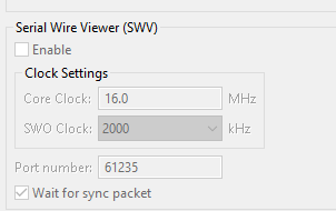

‎2021-01-28 2:57 AM
it is possibile that this can cause the problem? My core clock is 8MHz but I can not change it
