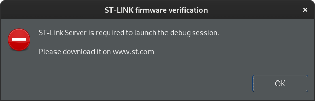

After I update STM32CubeIDE from 1.3 to 1.4.2 I can not start debugging process.
It says ST-Link server required, but I set Open-ocd for debugging.
What I cat to do? Please, help to resolve a problem.

I suggest you reinstall STM32CubeIde 1.4.0 from installer (it embeds also the STLink Server install).
Then, you can update to CubeIde 1.4.2 to have the latest version.
LaurentL
And see the answer of Miyago in this post https://community.st.com/s/question/0D50X0000BsQkvySQC/installing-stm32cubeide-on-opensuse-tumbleweed
He said :
I use OpenSUSE leap 15.1 and had the exact same problem as you with the rpm bundle.
I used STM32CubeIDE Generic Linux Installer instead and it worked without any problems.
