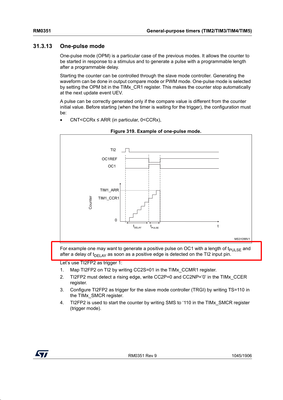

Just reiterating: HAL_TIM_OnePulse_Start() and its "framework" is *not* what you think based on its name, i.e. it's *not intended* to produce one single pulse on one output of the timer upon calling this function. It is intended to demonstrate one particular example from the RM (which is one of the many examples which don't not belong to RM and should be moved to an AN, but that's another issue), namely this one:
So, it always uses *two* channels, one set as input, and other as output. If you don't set them using the methods intended (which I am not interested in finding out, but you should really examine the example in Cube which is intended to demonstrate HAL_TIM_OnePulse_Start()), those two channels will set neither as you intended, nor as that example intended.

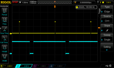

on F303 : 72MHz core + timer
TIM3 . ch1 as TI1FP1 , ch3 as output 500us pulse, 1500us delayed (blue)
TIM8 .ch  100us pulse every 5ms as trigger (yellow)

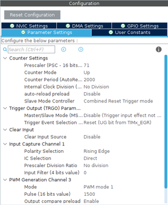

Cube setting:
start in main:
  HAL_TIM_OC_Start(&htim3, TIM_CHANNEL_3);

Exactly what it should do.
