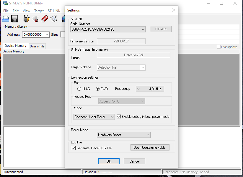

0693W00000FDBsFQAX.pngSo I used the STLink Utility App and these were my settings, as soon as I press Okay I get the following :

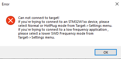

0693W00000FDBsjQAH.pngThen when trying to erase the chip, it gives the same error. I watched a few videos and most of the poeple just press the reset button (which I have on the board) and release it again after pressing erase chip, but this also isn't working, because it doesn't even want to connect to the chip, but I can update the firmware on the chip using STLink Utility.
I would try using STM32CubeProgrammer. The ST-Link Utility is deprecated.

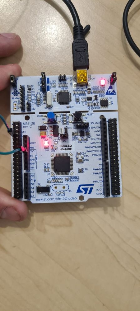

To boot into the bootloader, connect BOOT0 to 3.3V, then reset the board by holding NRST low briefly.

0693W00000FDC5EQAX.jpgSo this here is my board, my NRST Pin is just above my 3V3 Pin, so I am not sure what you mean by holding NRST low briefly, and should I be doing anything else in the programmer at this time?

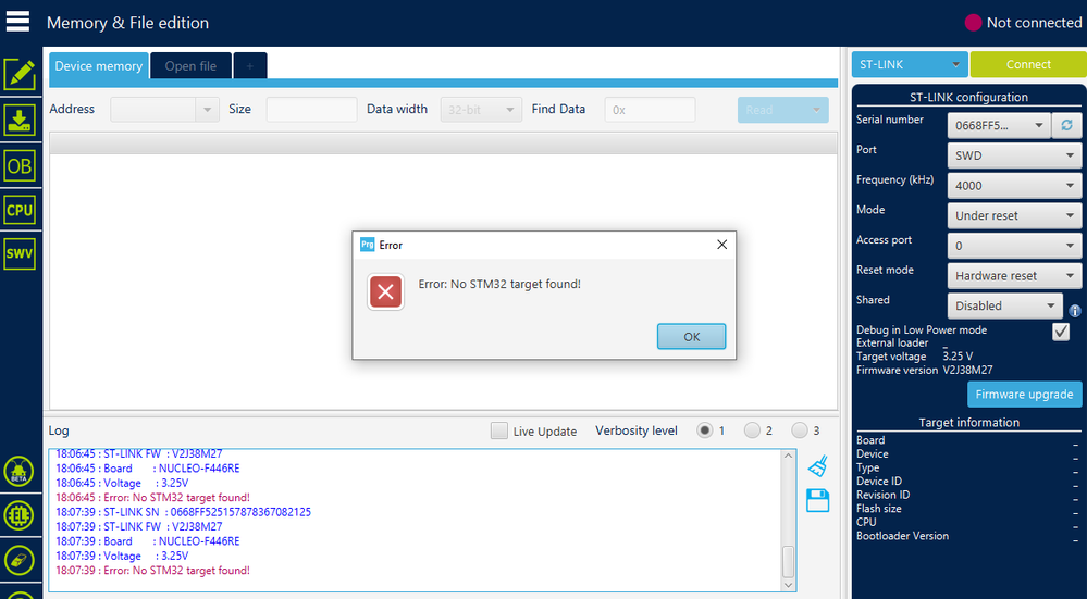

These are the settings in my programmer but when I click connect it shows that it is picking up the board in the log but it keeps showing that the target isn't found
