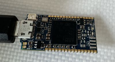

That's true! I just switched over to a STLink V3 Mini and I'm having a little bit of trouble figuring out how to connect it without the header in ST's image of the product. This is my STLink V3 Mini and it looks legitimate, and I checked the shipping details and it does seem to be genuinely from ST this time:
According to ST's product description, it's supposed to come with a debug header which this chip did not, so it's a little difficult to use.
