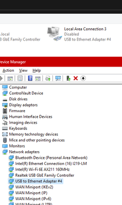

  1. It Gets Detected as Ethernet Adapter on Windows, But the Adapter is Disabled on Network Adapter Settings thereby unusable on Windows.
    2. Changing PID and VID too doesn't work

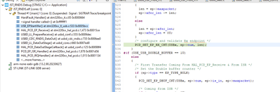

  2. It Gets Detected on Linux Platform and is also Enabled, Unfortunately Post a Specific Number of Packets (i.e. ~ 70-85 Packets) the Code Runs into a HardFault_Handler.Pavan_LohiaGroup_0-1719303720521.png

The Issue I had earlier mentioned, i.e.
This has been fixed, The Fix was as below
In the Source File, usbd_cdc_rndis_if_template.c, Under Function, CDC_RNDIS_Itf_Receive(uint8_t *Buf, uint32_t *Len), I had to Set the UserRxBuffer and not &Buf[0]
i.e. USBD_CDC_RNDIS_SetRxBuffer(&hUsbDeviceFS,UserRxBuffer);
But Now, I see another issue, i.e. The Data received is not as what is being sent. I see it as
  • either the Data in the Buffer is Jumbled or Has Extra Bytes which weren't a part of the actual data
  • Certain data is lost in certain packets too
Issue with Window's being disabled still persists
