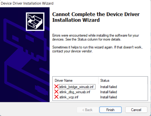

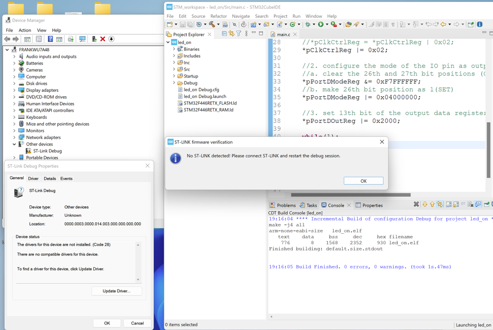

I have tried many ways to solve this question.
Is anything I missed? Please help. Thanks so much!
My OS is windows 11.

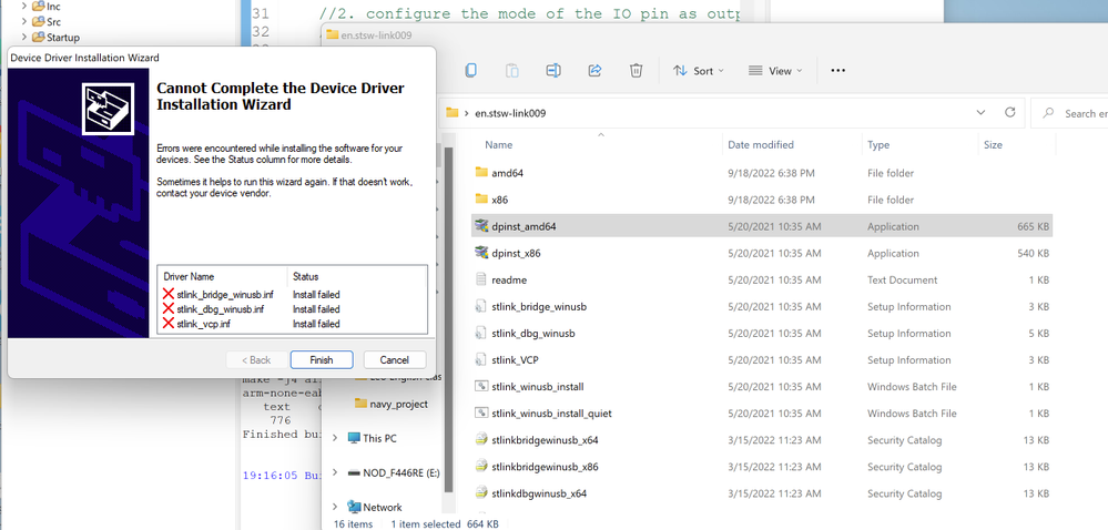

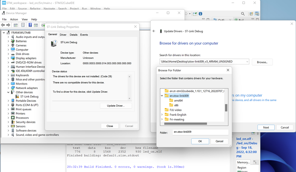

Unpack the .ZIP to an actual/real directory
Device Manager,
Update Driver
Specify a directory, that of the amd64 subdirectory as unpacked above

Try changing Micro-USB cables (use a good quality USB Cable), and make sure that you are using a current firmware.

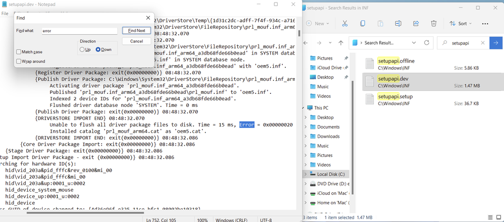

Pavel A.
Please find this file on your PC: C:\Windows\INF\setupapi.dev.log
Is there any error related to installation of these drivers?

@FWu.3​ The posted log file screenshot does not show anything related to st-link (it is not a mouse). It is not obvious that the problem is caused by wrong signature.
