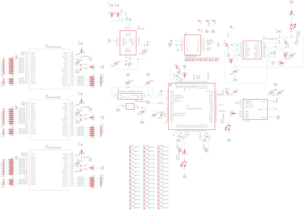

Circuit (programmer given by SAMTECH part) (zoom in to see):
0693W000008xjpxQAA.pngWhen I connect STLINK V3 Mini to program the STM32L4676RG MCU, it detects the chip without errors. However, when I try to flash, STLINK generates fail.text.
Any idea what's happening?

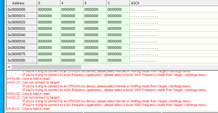

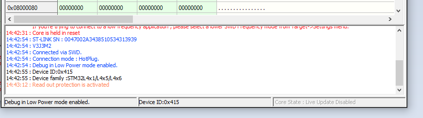

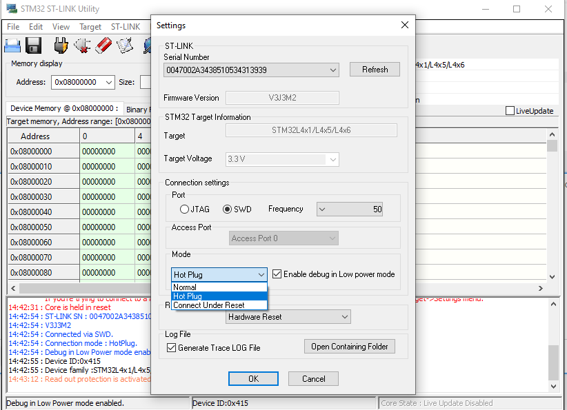

  • To further explore the issue, I ran STLink Utility to do a hardware reset via chip erase in connect under reset mode. It seems to automatically detect the chip properly with correct voltage and model and all in hotplug mode. This means my circuit is more or less fine as well as the chip:
  • However, when I try to connect in "connect under reset" mode, I get the following error:
  • I don't get the same error in "hotplug" mode, however, I cant do a hardware reset as the following error is shown:

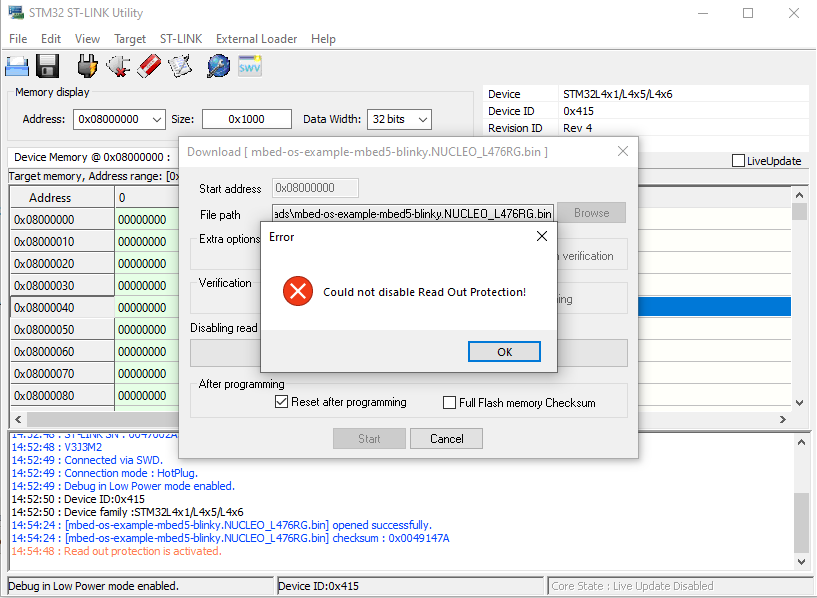

In addition, when I try to forcefully upload a bin file by bypassing readout protection, I get the following error:

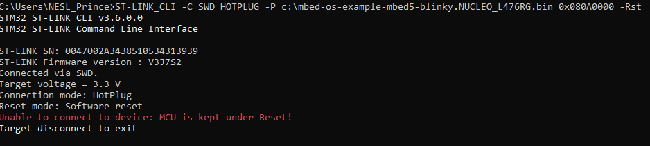

0693W000008xqd5QAA.pngOutput of STLink CLI
