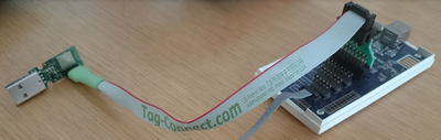

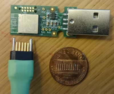

To add to Andrew's observation, Tag-Connect has grown popular as a means to do SWD connection on STM32 and similar platforms.
Indeed it has!
https://www.tag-connect.com/
I remember meeting the inventor when he was over here first promoting it back in 2010!

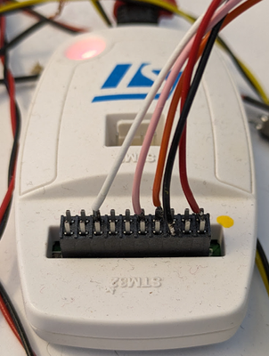

Easy. Just get a new ST_Link V3 and wire up anything to its open contacts.
not that it's hard to wire up a custom connection to a standard St-Link:
8)
