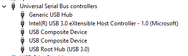

After installing the ST-LINK V2 on Windows 10 (STSW-LINK009) should there be an entry in the device manager under USB Controllers for the STM Device? My computer did not have any entries after that install. See image below.

JBrin
So your solution was related to faulty hardware. Is that correct? Does the USB driver now show up in the Device Manager with the new hardware?
MGrze
Hi Jeff, the device Manager in Windows 10 shows now an additional point "USB-Devices" - "STM32 STLink". I didn't install any additional drivers. Just connected the new ST-Link/V2 and it works! The red led is lightening, not blinking. The old, broken device showed only blinking red light.
