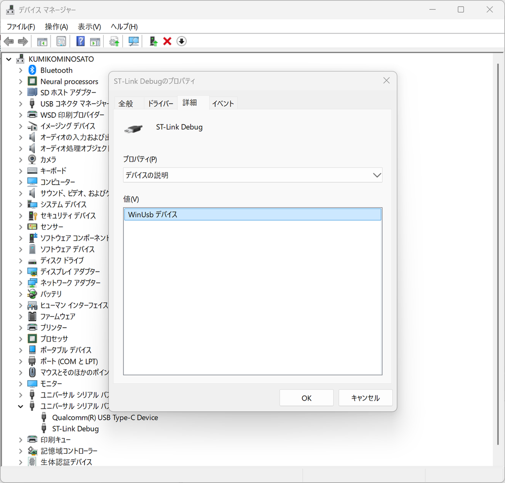

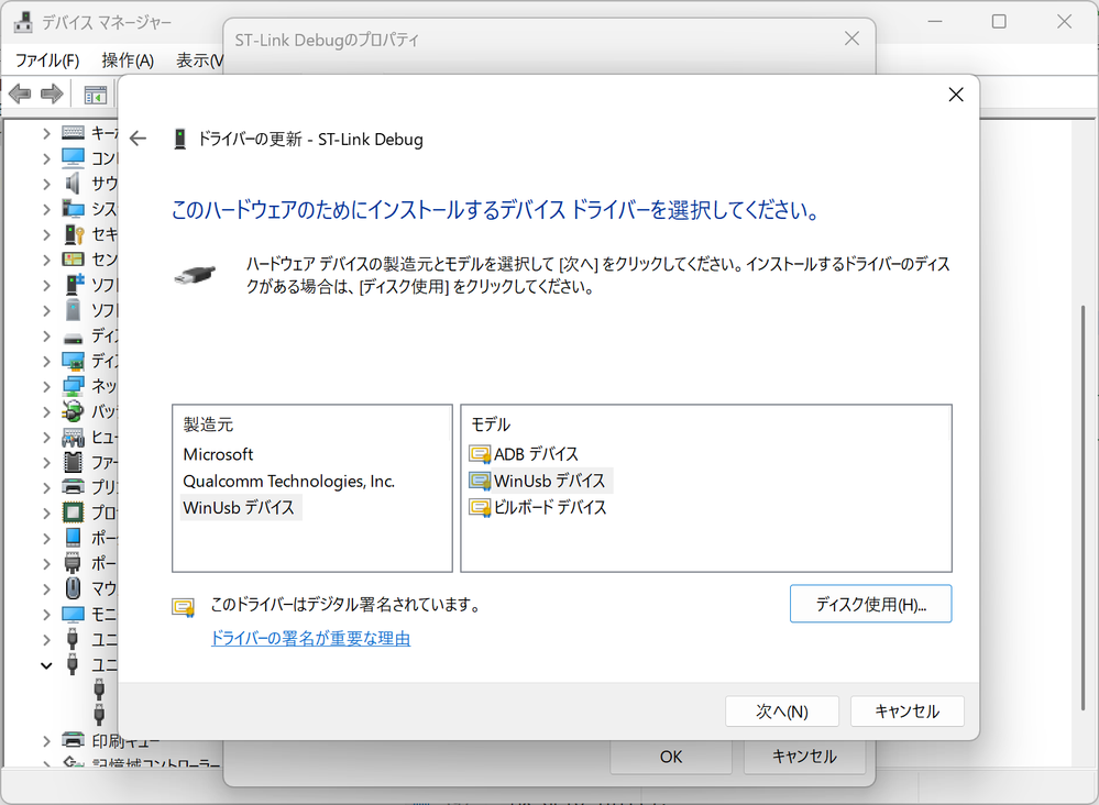

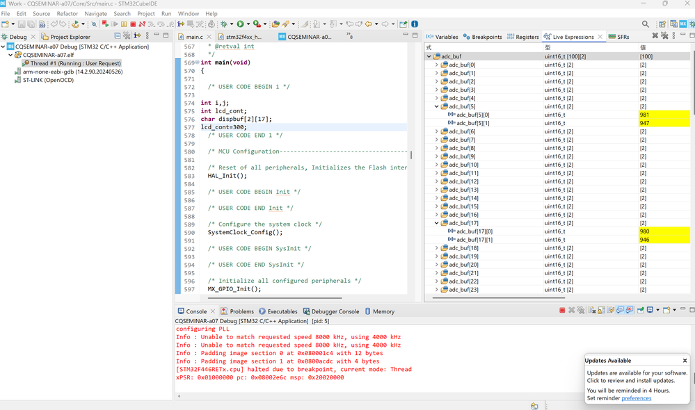

スクリーンショット 2025-07-08 234716.pngHello I had struggled similar things on my Lenovo YOGA slim.
It used Qualcomm X-ELITE chip as Copilot+PC Windows11.
Now I can use STLINK/V2 (NUCLEO-F446) using with Windows driver WinUSB.
But also setting is changed as OpenOCD that was built in version of CubeIDE V1.8.1.

STLINK side is nothing changed and it can use both x86 machine as STLINK and XELITE machine as OpenOCD.スクリーンショット 2025-07-08 235415.png
I have installed winusb driver as forced from unrecommend driver as above.
