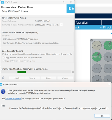

I have a Discovery board B-L072Z-LRWAN1 and I am trying to set up a project using CubeIDE but get the following,

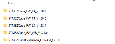

So I check to see if the L0 & LRWAN packages are in the repository,
Yes, they're there. I click OK & Cube carries on setting itself up & up pops the ioc window. I press configure & generate & get some C code but the build option is greyed out.
What am I missing here?

version 1.17.0
Interestingly the examples for both the  L0_FW & the LRWAN for the board open up & build with no issues.
I guess the examples are already complete - don't rely on stuff installed in the IDE ?
No idea, why would Cube not allow a new project to build given that it knows where all the support drivers for the board are?

mattias norlander
Hi @NicRoberts ,
I am fairly convincned that the issue is MX/FW related rather that IDE related... Let me explain the process:
  1. When MX is generating resources into a new or an existing project it first tries to generate c/c++ code
  2. Once all code has been generated the the last step is to create/update IDE project files (.cproject/.project files in case of CubeIDE...).
If the first step fails, then for new projects you will not even have IDE project files.
The file tree in CubeIDE may show you source code, but without .cproject/.project files there is no description on how to build the projects, consequently the build toolbar buttons would be greyed out.
Since MX failed to detect or download the selected FW version the first step failed, as a consequence you ended up with some source code but broken .cproject file and the consequence is that the IDE has no clue how to build the source tree. It cannot even understand that this file tree is an Eclipse/CDT (CubeIDE) project.
I leave this explanation for other users who may one day this issue so that they can understand the reason why.
