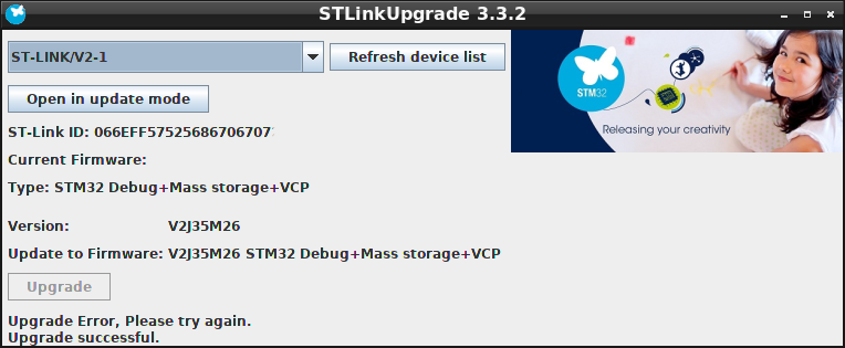

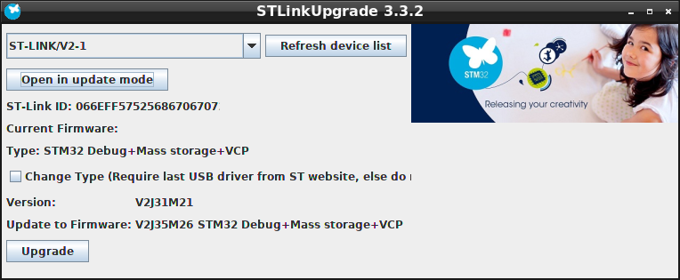

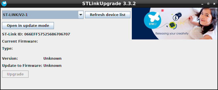

sphil.931
0690X00000ArhEWQAZ.png0690X00000ArhElQAJ.png0690X00000ArhF5QAJ.png0690X00000ArhEqQAJ.pngI would hazard to guess a few images to give a better description, in addition I ran a few tests.
I've given images to show what I am seeing.
I ran the upgrade JAR as root. With the same results (had to do some work using Xephyr to have any output but that is a digression).
However additional output from the CLI was available:
"libusb: error [udev_hotplug_event] ignoring udev action bind
libusb: error [udev_hotplug_event] ignoring udev action bind"
was output when attempting to upgrade.

It looks like it recognizes it as a st-link and then sets it up has a USB mass storage device.
What the Heck?
I suppose next I need to try another computer.
