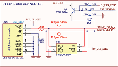

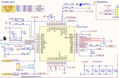

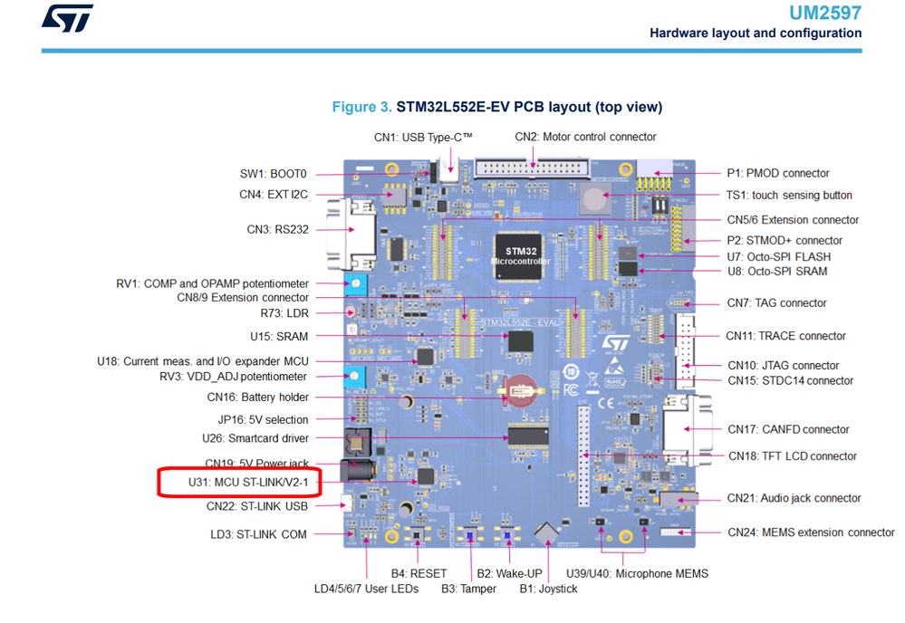

I have a evaluation board STM32L552E-EVAL, and I would like to know what is this part used for ?
I see 2 pins (USB_D_N and USB_D_P) that connect to the STM32F103CBT6
What is it for ? To program the component and debug. Thank you for your answer
Regards
Yann DO
Andrew Neil
@DYann.1 wrote:
the STM32F103CBT6
What is it for ?

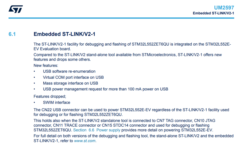

That is the ST-Link - for programming and debugging
https://www.st.com/resource/en/user_manual/um2597-evaluation-board-with-stm32l552ze-mcu-stmicroelectronics.pdf#page=8
via: https://www.st.com/en/evaluation-tools/stm32l552e-ev.html#documentation

Uwe Bonnes
Principal III
It is ESD protection
Andrew Neil
What part - the USBLC6-2 ?
Its datasheet tells you what it's for:
https://www.st.com/resource/en/datasheet/usblc6-2.pdf
via: https://www.google.com/search?q=usblc6-2sc6
I'd have thought this would have been readily obvious, the on-board debugger. ST-LINK/V2-1
Provides the USB CDC connectivity to a L552 UART, and an USB MSC to drag-n-drop firmware binaries, as originally used by mbed

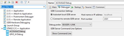

Thank you, in fact I would like to program and debug via J-LINK SEGGER. In fact, on my real card I do not use the ST-LINK (for consumption). Do you know where I can find the information to configure the J-LINK to be able to work under STMCubeIDE ? I can see some information but it's not very clear for my.
Thank you
I'd imagine under debugger settings, perhaps videos on YouTube if reading not strong
See this if you want it to present as a "J-Link OB"
https://www.segger.com/products/debug-probes/j-link/models/other-j-links/st-link-on-board/
I will look at this link. I can work with the J-LINK with my STM32L552xx evaluation card but I still need the ST-LINK usb connector otherwise it doesn't work under STM32CubeIDE. I just need to select J-LINK :
So according to your previous answer, I guess ST-LINK usb is for programming and J-LINK is for DEBUG, right ? If I remove the ST-LINK usb then it does not work.
Thanks
No, not at all.
Both J-Link and ST-Link are full programmers and debuggers.
But this is a different question from your original (solved) one - please start a new thread for a new question.
