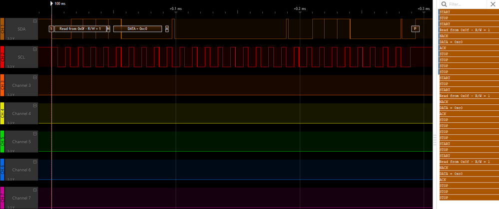

I have a screen mounted on I2C that originally communicates with an Arduino board via its address 0x3C. I have verified that I can communicate with this address using my Nucleo 64 F401RE board.
However, when I look at the frames, I encounter information that doesn't match up. Worse, when I look at what HAL returns, I get a rather strange error that I would like to submit to you.

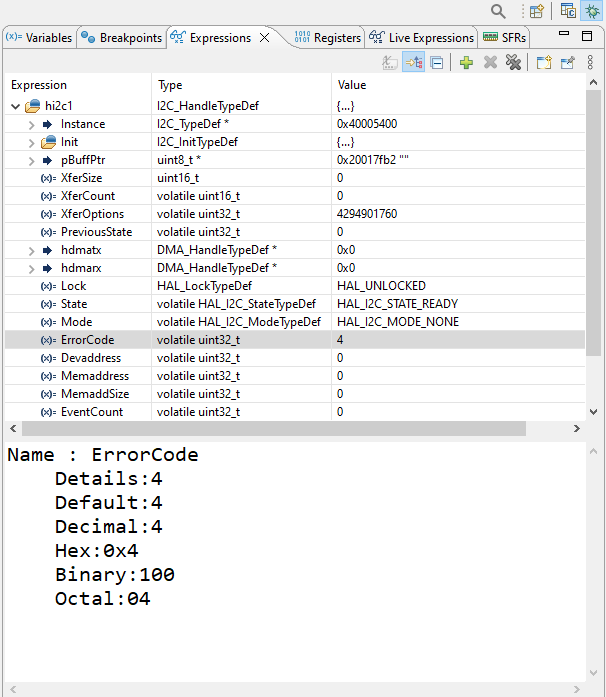

  • HAL returns the error Name: ErrorCode / Details:4 / Default:4 / Decimal:4 / Hex:0x4 / Binary:100 / Octal:04
  • The problem is not isolated to a specific part of the code, but I am scrutinizing a particular part of the code when I transmit data

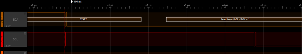

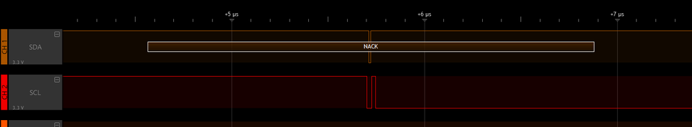

I am also attaching images to illustrate the frames and errors encountered.
Error during debugging, HAL returnError during debugging, HAL return
General frameGeneral frame
Frame focused on the clockFrame focused on the clock
More detailed clock frameMore detailed clock frame

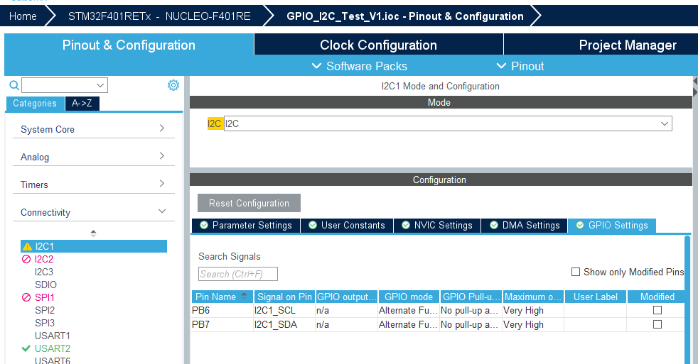

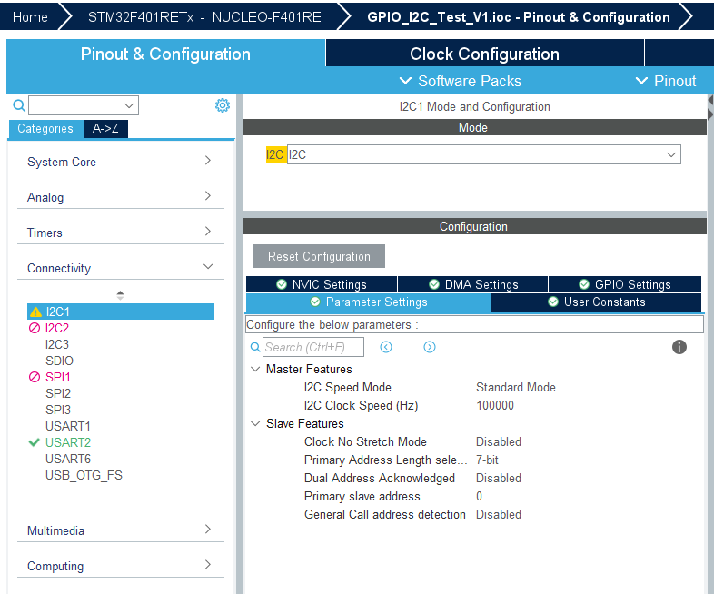

I²C configurationI²C configuration

HAL_I2C_ERROR_AF (4)
ACK failure from the device
Might look at how you have this wired up, the pull-ups, the timing. Anything else on the bus it might be interacting with?
Is this on some board / module? Like to a shop or Amazon, in case someone is working with a similar part.
Can you clear the error and retry? Sitting in a while loop won't get resolution, but suppose the GPIO here is used as a trigger for the logic analyzer so you can inspect / review the specific failure.

check the documentation of your STM32 board to ensure that you are using the correct pins and those signals are routed to the place where you are connecting the display. If possible try to test with another i2c device to  make sure that the I2c bus of the STM32 is working as expected. Are the pull up resistors connected to processor VCC? What is the operating voltage of the Display, if there is a mismatch or not?

My signal is well routed, since we see it appear with a SCL and a SDA with pinoches configured by cubeMX.
The screen has already worked under STM, but not in a correct and durable way. I didn’t know what error 4 was. Go back to the subject to see the images I posted. It will speak, much more than all my writings.
