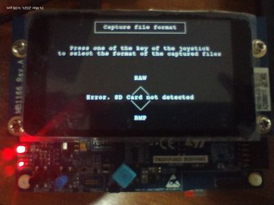

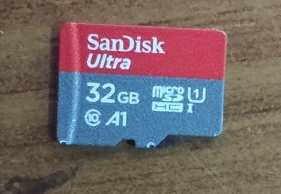

I am using STM32H747-DISCO with the FP-AI-VISION1 package, I have updated my drivers and solved the screen problem. Now I am facing an issue with the SD card. It is given that an SD card with class 10 is recommended, I am using SanDisk Ultra microSDHC class 10. While testing it shows SD is not detected, I don't know what the problem is, SD is working fine with my PC. Please help me out.

I have the exact same issue, on my STM32H747I-DISCO board (revision D03) using the same Sandisk 32 GB SDHC Ultra Micro-SD card (model number SDSQUA4-032G-GN6MA) that you show on the picture.

But when I instead compiled and flashed the STM32H747I_DISCO_PersonDetect_MobileNetv2_CM7 binary from  FP-AI-VISION1_V3.1.0, I also got the message "Error. SD card not detected" when I tried to enter the "Frame Capture" mode and select RAW or BMP file format.

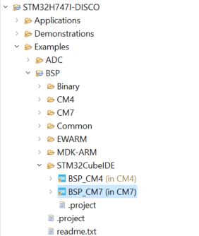

I opened the BSP directory of STM32Cube_FW_H7_V1.11.1 as shown in the project explorer below:
I compiled both the CM4 and CM7 projects and programmed them via ST Link (CM4 first), but the result is that the LCD screen of the STM32H747I-DISCO is filled with random noise and I cannot interact with the demo. Do I need to update some LCD drivers to make it work, or is there something else missing?
