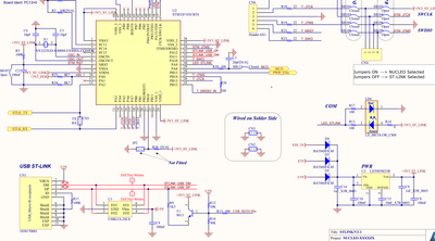

What can i do to fix the over current problem.i have a nucleo-F767ZI board and  it seems that by trying to power on a display there is a problem with the circuit at the backlight and now i get the LD5 for the over-current always on.
At this stage i do not care about the display at all i need to be able to make the nucleo work normally by it self without an display.
When i place power on stlink the over-current led is on and i can not connect to stlink with STMCubeProgrammer or with IDE.
What can i do to fix the issue to work again normally?

Well if it continues it is more indicative of damage to the supply, regulation or IO pins of the STM32. Guess you'd start by measuring currents and checking voltages. Things you might have damaged, or shorted.
Pull a schematic via CAD Resources tab.
Kyrpav
i got the schematics but from where to start? I suppose it is something from
this parts not from the real mcu. still i am in a not comfortable situation here. if something was to be burned what wound have been first in order the led to start light?
I don't recall what it is sensing, perhaps undervoltage. Start by following the current ingress pathways. Perhaps get a USB current meter and see if that's pulling excess current.

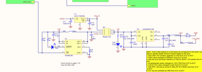

i will probably by infiray p2 pro in general but i think i have found the problematic part by touching. The ST890CDR is burning. I need to buy new to replace it.
I have the exact same problem. Replacement ST890CDR cannot solve the problem.
Have you tried? How do you solve it?
