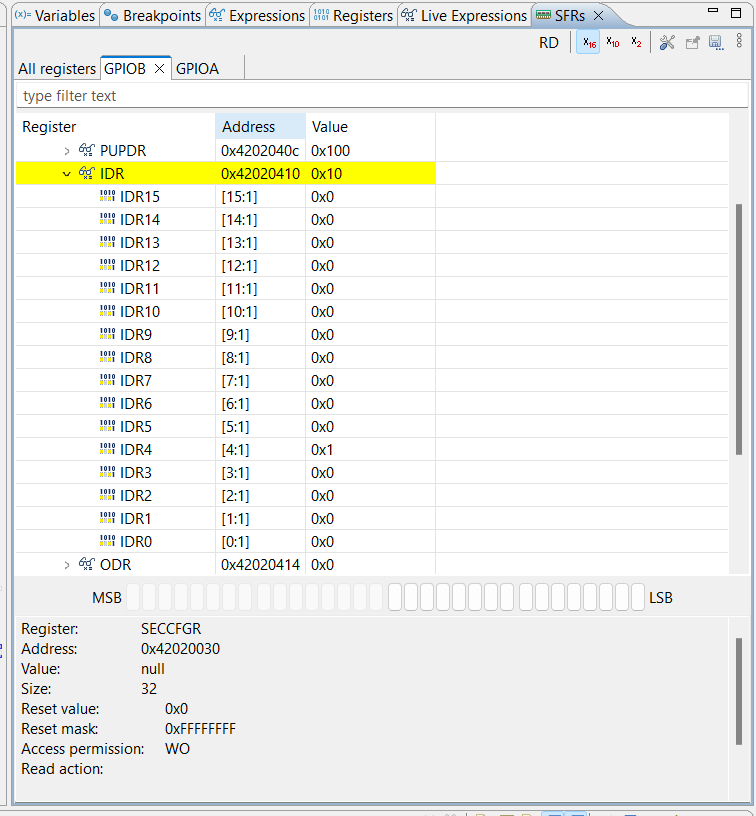

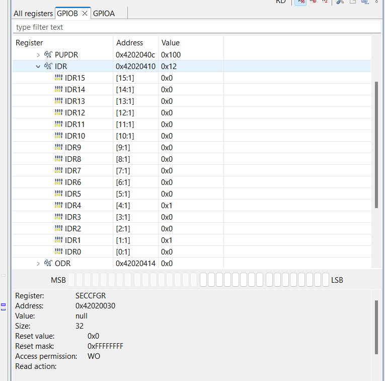

When I observe the GPIO levels in the live update of the GPIOB->IDR1 Register under SFRs I'm seeing the change in the levels according to my input. But that is not reflecting to the ISR funtion. the falling edge is not triggering the callback function.
So you observe PB8 is changing?
> #define NDRDY_Pin GPIO_PIN_8
> #define NDRDY_GPIO_Port GPIOA
> #define NDRDY_EXTI_IRQn EXTI8_IRQn
You defined the pin as PA8. GPIOB->IDR won't have any effect on it. Maybe recheck your pin assignments/assumptions here.
Always helps to show screenshots to show us what you're seeing.

I have easy controll on pin PB1 as it is connected to the external pushbutton with a pull-up circuit.
when the pushbutton is not pressed :
 GPIOB -> IDR1 is high
when the pushbutton is pressed :
 GPIOB -> IDR1 is becoming low
