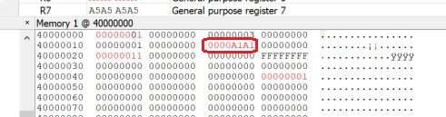

I'm using a Nucleo-F746ZG with timer 2 as a quadrature encoder input. I'm feeding it quadrature signals from 2 GPIOs at 250Hz (each phase is 1mS).
The CDR value is 0, so FDTS should be CLK_INT (36MHz for APB1). With both inputs' filter set to 8, the quadrature counter works flawlessly, counting from 0 to 10,000 and back to 0 for 60+ hours. A filter setting of 10 also works flawlessly. On my ancient 20Mhz scope the GPIO signals are very clean with a low drive setting.
Setting the filter to 9 produces random, spurious counts.
I'm not sure why this notch should exist. My calculations are that a filter of 8 takes 1.33uS to match, 9 is 1.78uS, and 10 should take 2.22uS. If 8 < 9 < 10 how does 8 and 10 work and 9 does not? Shouldn't a filter setting of 9 also have a 1000x chances to match the input (2mS / 1.78uS).
I also see the filters >=12 start to prevent accurate counts. Again, these seem very fast compared to a 250Hz input signal and it seems they should all match OK.
Thanks!!

MNels.3
Yes, the CR1.CKD value is zero. Sorry for the confusion.
I'm using the cubeMX generated code, changing the filter value, and recompiling and reflashing. This is from main.c.
  htim2.Instance = TIM2;
  htim2.Init.Prescaler = 0;
  htim2.Init.CounterMode = TIM_COUNTERMODE_UP;
  htim2.Init.Period = 4294967295;
  htim2.Init.ClockDivision = TIM_CLOCKDIVISION_DIV1;
  htim2.Init.AutoReloadPreload = TIM_AUTORELOAD_PRELOAD_DISABLE;
  sConfig.EncoderMode = TIM_ENCODERMODE_TI12;
  sConfig.IC1Polarity = TIM_ICPOLARITY_RISING;
  sConfig.IC1Selection = TIM_ICSELECTION_DIRECTTI;
  sConfig.IC1Prescaler = TIM_ICPSC_DIV1;
  sConfig.IC1Filter = 8;
  sConfig.IC2Polarity = TIM_ICPOLARITY_RISING;
  sConfig.IC2Selection = TIM_ICSELECTION_DIRECTTI;
  sConfig.IC2Prescaler = TIM_ICPSC_DIV1;
  sConfig.IC2Filter = 8;
  if (HAL_TIM_Encoder_Init(&htim2, &sConfig) != HAL_OK)
    Error_Handler();
Timer 2 regs. This changes from 0x00008181, 0x00009191, and 0x0000a1a1 for this issue. It's CCMR1 when in input capture mode.
Thanks for the help!
waclawek.jan
All this looks exactly as expected.
Well, that's then strange indeed, and if the value of CCMR1 register is the only thing which changes between the cases, don't know the reason for this behaviour...

I think I found it. The GPIO signals were flawless until I plugged GPIO_B in to PA1. Suddenly it has a 50MHz, 1.5Vpp signal on it. We had long since removed Ethernet in cubeMX, but the PHY is still attached to pin PA1 via SB13. It's referenced in Table 12, but a real schematic would have saved a lot of time and trouble.
