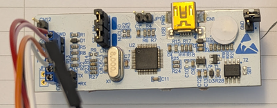

Opened up a new Nucleo-L476RG board (finally worked my way through the 10+ boards I bought a number of years ago) - it comes in a cardboard box now, nice.
The Leds (LD1, LD3) were so bright, I couldn't probe anywhere around the micro or connectors without squinting. So I replaced the resistors for these Leds (1K, 100?) with 22K, things are much more mellow now.
Most people are using these boards indoors, the Leds only have to be bright enough for people to notice - not beaming out like the Eye of Sauron.
Anyway, something for you to think about. Meanwhile, there's a few annoying clouds outside I need to shout at....

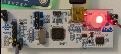

That's why I have a sticker on the LED of this Nucleo ST-Link:
@Mike_ST  -  As @David Littell said, it's always been thus - not specific to any particular model or revision.

I tend to agree as well. Really annoying if you want to measure something on the board.
One suggestion is to use a permanent marker  (of you favourite color) to paint onto the LED to dim it down.
Or use something like frog tape (adhesive tape used for painting), which is somewhat semi-transparent, so you can still see the light.
