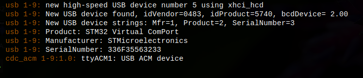

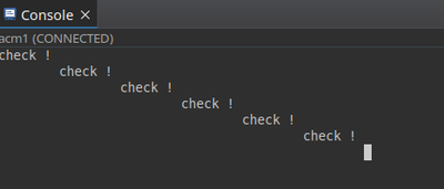

I just tried: make CDC on H7S3nucleo , core at 360M , just in Cube set USB_HS:
 first try, connect to PC (LinuxMX) :
So Cube seems working as it should.
And can see connected working:

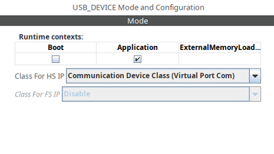

I tried to import your .ico file, but I get a build error. Missing "buf" in linked_list.c. Anyway, I notice that your configuration does not use boot, it only has the application. I am only using boot as I want to use the internal flash memory and won't exceed its size. Could that be an issue?
no, just set all you want for the "boot" then.
But...why use such monster cpu and using only the small boot flash?
you asked for ioc only, so i did.
buf is
int16_t buf[1024]  __attribute__ ((aligned(32)));
But if not needing SAI and DMA , just disable it in ioc , so its away.
So here ioc , only using internal flash.
