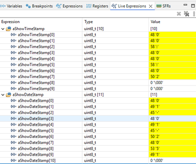

I am going to attach the project so you can test it yourself. Maybe it will help, or you can use it as a reference if I understood your case correctly. If not, can you provide more details about your problem?
The project is initialized at 23 hours, 59 minutes, and 30 seconds.
You can see the time by following these buffers in live expression when you launch a debug session if you are using STM32CubeIDE:
  • aShowTimeStamp
  • aShowDateStamp
The date will be updated once it reaches the 23 hours, 59 minutes, and 59 seconds mark, as shown in this screenshot.
