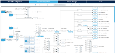

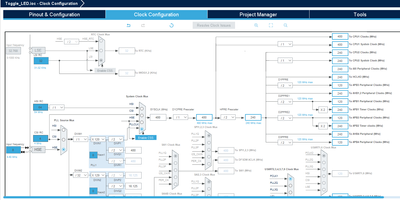

I want to use Nucleo-H745ZIQ board with operating clock at 480 MHz for M7 and 240 MHz for M4. Below is the clock configuration.

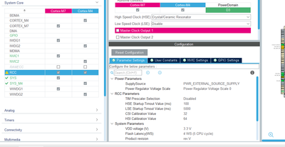

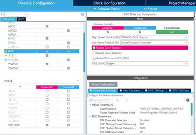

Under RCC, options are either PWR_LDO or PWR_EXTERNAL_SOURCE_SUPPLY selection enabled. Voltage scale as Power Regulator Voltage Scale 0.

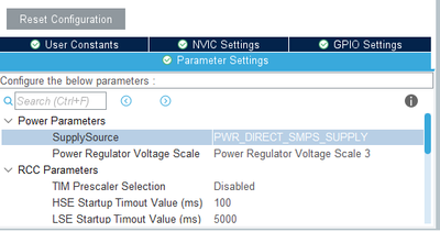

Then I cut down the operating speed to 75 MHz for M7 and 60 MHz for M4 and selected Internal power supply and programmed again. Found working okay.

set rcc to PWR_LDO and try.
@AScha.3
Did with PWR_LDO but found same issue.

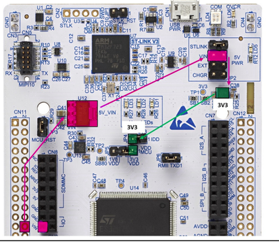

control voltages when debug : vin, 5v , 3v3 , 3v3 for st-link .

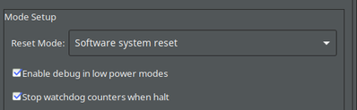

@AScha.3

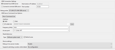

Debugger setting... Software system reset
Normal debug is working if I set clock frequency to less than 100 MHz and with below set up
control voltages are also okay.

How current is sink from your 9V? Is stable

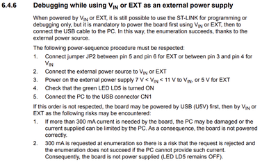

Hello @Nsg1987 ,
Please make sur that you are following the recommendation in this section : 6.4.6 Debugging while using VIN or EXT as an external power supply.

@Foued_KH
Yes...I am following the same sequence.
But still facing the same issue. Could you please suggest clock configuration required to operate the board with maximum speed i.e. 480 MHz

roughly 120 mA. 9 V supply is given from regulated power supply which has capability to provide up to 5 A current if required and power supply is stable. VIN pin is accepting voltages from 7 V to 11 V.
