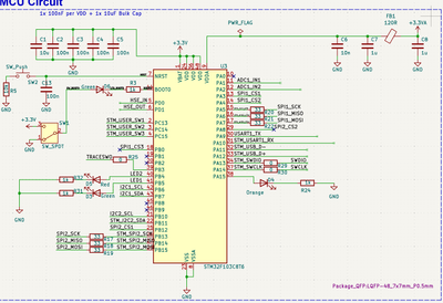

Dear all,
I'm unable to connect via SWD to my STM32F103C8T6. What ever I try I get no target found with STM32CubeProgrammer or ST-LINK Utility (I have tried all combinations at slow and high speeds).
- device is virgin
- BOOT0 is low
- NRST unconnected (shows 3V3) and connected/removed while testing
- Connections go through from ST-Link to STM32 pins
- 30 Ohm and 0 Ohm tested for SWCLK and SWDIO (GND and 3V3 connection to ST-Link with no resistor)
- Correct mapping of ST-LINK pins to STM32 checked multiple times
- There are no obvious shorts between any of the paths
- 3V3 is stable and GND closed
- The ST-Link was tested with a "blue pill" board with the same STM32 on it and it worked flawlessly
I have also tried:
- Cutting the path to the esternal 16MHz crystal curcuit
- Connecting/Disconnecting VCC
- Soldered a new STM32 onto the board
I am currently running out of ideas, I think there is either a fault in the PCB design that damages the MCU or prevents booting or maybe some config that I have missed? I'm grateful for any ideas..

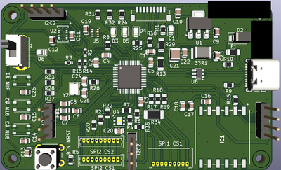

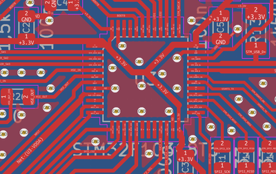

Some info on the board: It's a 2-Layer 1 mm board with a solid GND plane on the backside, I have attached sreenshots of the schematic and the routing. Please not that the LED on the BOOT0 path has been replaced with a 0 Ohm resistor to actually pull the pin low. Please let me know any further info required.

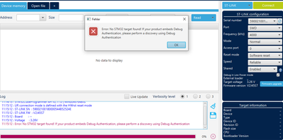

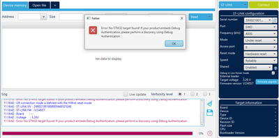

Hi, so this is what I get.
There is one peculiar thing: When I switched on the power with the previous MCU (before desoldering it) the LEDs D3 and D5 lit up very dimly, leading me to believe the chip was faulty, the new chip also did it shortly but stopped after I disconnected it from power immediately. (Not a good sign either) A test with an older, less complex PCB design (different purpose board) also showed LEDs glowing dimly after some seconds but here the SWD is indeed working. So I'm asking myself again if the my new chip is faulty and if the problem is with the board design. Is it normal for some regular unprogrammed GPIO pins to go high after boot? One problem I could see is that 3V3 connection to the ST-LINK is straight through without a resistor and when I unplug the PCB the ST-LINK will feed the 3V3 to the board - might that have damaged something?
PS: Is there any way for me to check if the MCU is defective or not? I usually read that its not easy with virgin devices, but maybe with an oscilloscope probe to specific pins?
AScha.3
October 19, 2024
Yes. See pin functions at start/reset : you need sdw, jtag working, so these pins do something, pullup on, etc.
Not really ; see power consumption -> normal , as ds tells ? chip getting hot or pulls no power at all ?
ESD handling ...? solder station grounded/ESD protected ? --- just some indication , not more.
Then connects on swd ? (Thats my usual "test" : cpu seems good - or not. )
The F103 is very old, i had my first about 14 years ago; so its impossible , that you discover a "new" problem on this series.
If your swd/swc pins are connected to st-link (not puzzled! )and cpu has 3v3 : it will connect - if alive.
So if you sure, all vcc/vdda/gnd is connected and power consumption looks "normal" : it will connect.
Otherwise: find the hardware/connection error.

akenviAuthor
October 22, 2024
Thank you,
apparently it was the VDDA pin that was not powered properly. With the pin powered the MCU boots and connection via STM32CubeProgrammer was possible in a first try. I think that solved the riddle.

SWD lines (SWCLK, SWDIO) should be routed properly with minimal length and no sharp turns or excessive vias. These lines should also avoid high-noise areas. A solid ground return path for the SWD lines is critical, so verify the integrity of the ground plane and the connections between ST-Link and STM32. You mentioned that NRST is unconnected.  You can connect it directly to the ST-Link reset pin and attempt a reset before programming to ensure a clean reset signal. Before printing the PCB, it is always better to simulate the schematic. You can use simulation software for this task.
