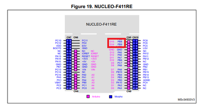

ADXL set up the same as the pic below (R - 4k7)
Anyone see anything obvious?
EDIT:: I added a function to see if there was a device attached it comes up "NO" everytime
int ADXL345_ScanDeviceID()
	for(uint8_t address = 0; address < 255; address++)
		if(HAL_I2C_IsDeviceReady(&hi2c1, address, 1, 100) == HAL_OK)
			return address;
	return 0xff;
 EDIT 2:: I'm an ***, I had the wrong pins in the Nucleo board wired up!
Yes thanks, I had the wrong pins in the Nucleo board wired up and the problem was matching the Nulceo board breakout header pins with the MCU pins. In my case I needed access to PB8 & PB9 which are found on the Arduino header at D15 & D14 respectively.

The I2C addresses are 7-bit, not 8, and the 7-bits occupy the higher order bits, on the wire, and in the STM32
The low order bit is for read or write indication, so NOT 0 thru 255
int ADXL345_ScanDeviceID() // Will find first decoding part
	for(uint16_t address = 0; address < 128; address++)
		if(HAL_I2C_IsDeviceReady(&hi2c1, address<<1, 1, 100) == HAL_OK)
			return address;
	return 0xff;
