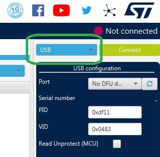

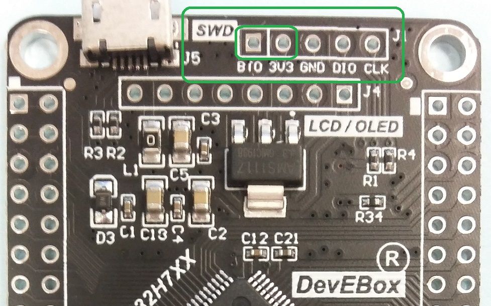

The DevEBox board has an SWD debug header, you need to attach an ST-LINK to that to do the debugging.

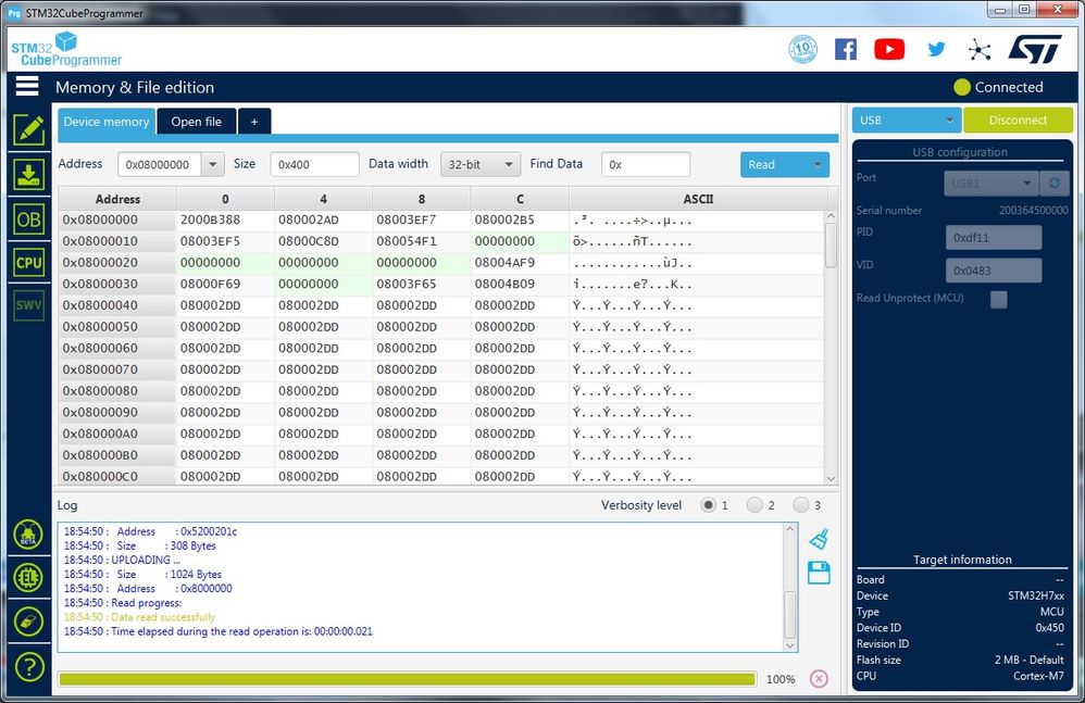

Via the USB, you're going to need to connect with BOOT0 High for it to enter the ROM loader, and then you'd need to use STM32 Cube Programmer in USB/DFU mode to push in the firmware. Jumper BT0 and 3V3 pin at the debug header

Make sure that the device is seen in Device Manager, something like "STM32 BOOT DEVICE"
Select USB connectivity mode, and select the device if there are multiple choices.

Win 7 x64 initially reports as "DFU in FS Mode" then as Windows finds a driver we get "STM32 Bootloader"
Make sure you allow Windows to find/download the driver, and that you don't have some "Unknown USB' device in Device Manager.

Boot mode is entered with BT0/3V3 jumpered, and the board brought out of a cold powerless state by plugging in the USB connection to a host computer.
Windows should make its ding-**** attachment sound. You should ideally connect directly to the computer, avoiding docking stations or hubs.
The alternative connection method would be via the SWDIO/SWCLK connections of the debug header to an ST-LINK/V2 or V3
