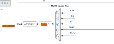

	// set the MCO1 to HSI
	RCC->CFGR &= ~(RCC_CFGR_MCO1_0 | RCC_CFGR_MCO1_1 | RCC_CFGR_MCO1_2);
	// divide the output by 15
	RCC->CFGR |= (RCC_CFGR_MCO1PRE_0 | RCC_CFGR_MCO1PRE_1 | RCC_CFGR_MCO1PRE_2 | RCC_CFGR_MCO1PRE_3);
	while(1);

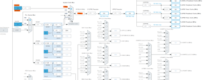

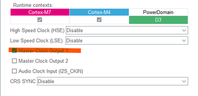

I tested it by configuring the clock tree in CubeMX and it worked, the output is about 4.2MHz, which is what I expected, but I couldn't do the same without the autogenerated code.
