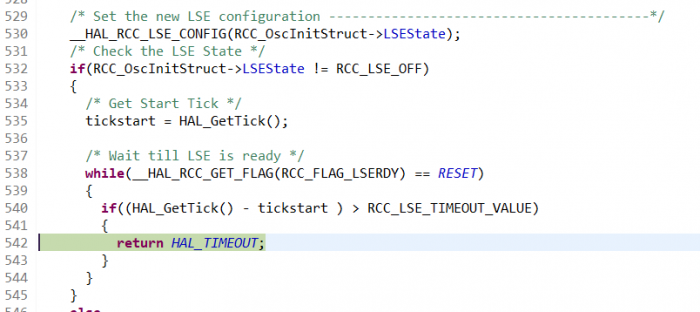

  4. Bug in STM32CubeIDE 1.6.1

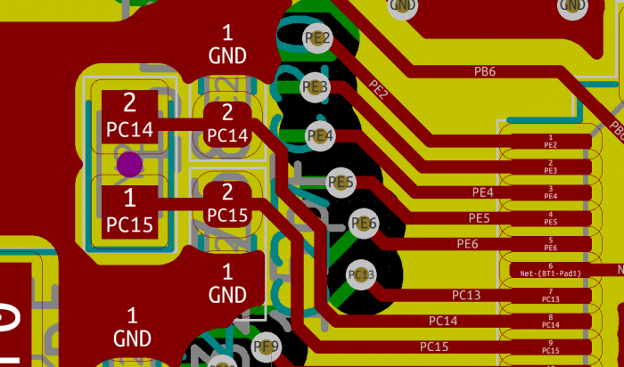

  5. Crystal is to far away from the MCU

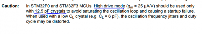

My setup looks like this. I'm using 15 pF capacitors because I computed them with the formula:
C = 2(CL - Cs) = 15
Where CL = 12.5 pF is the load capacity of the crystal.
Cs = 5 pF is the stray capacity of the board.
0693W00000BZvEEQA1.pngThe PCB layout for the LSE crystal. PC15 and PC14 is it mounted at.

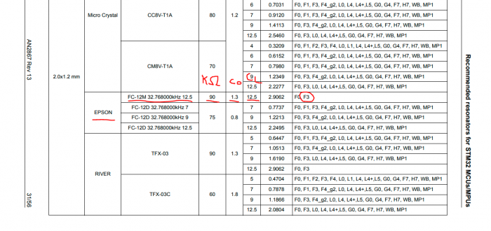

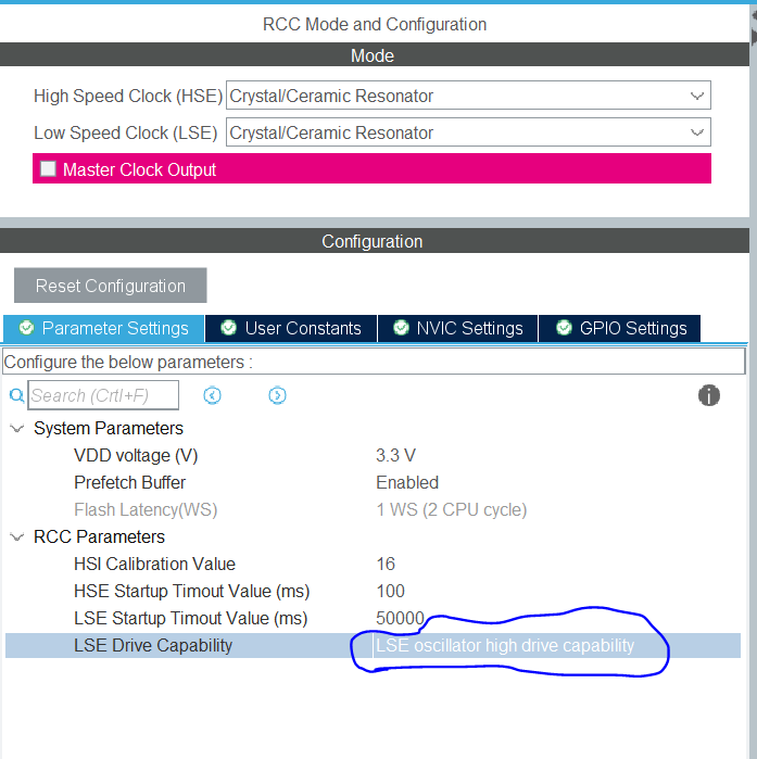

I have followed recommended CubeMX setup0693W00000BZvF7QAL.png0693W00000BZvFCQA1.pngI have selected the correct LSE crystal according from the recommendations from ST.

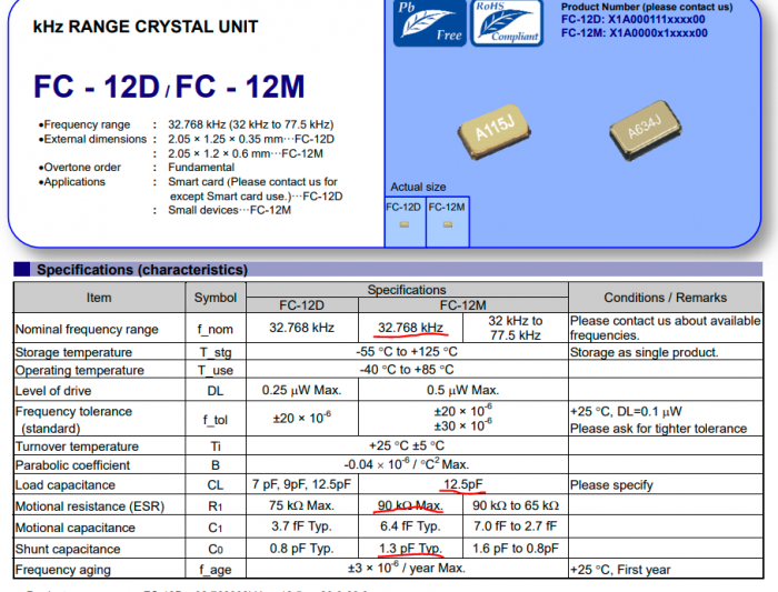

0693W00000BZvFWQA1.pngAnd the crystal information looks like this:

Of the things you can actually change, a pair of capacitors would seem to be the easiest.
Could you swap in some 6.8pF for example?
Don't rely on CubeMX, write a very simple app that just brings the LSE up, and routes to MCO or TAMPER (I'm not going to dig the DM/RM) so you can probe it without loading it.
Perhaps there is an RTC example in CubeF3, or something even simpler in the old SPL libraries.
STM32 parts are relatively hard to break, the fact it doesn't start any clocks automatically does make a signs-of-life determination more difficult, but sounds like you have code on it and it runs, just that the LSE fails to start, either at all, or within the time out window.
Or, try to swap in some 15pF capacitors (or just measure them with a LRC meter if you have one at hand) - we see here surprisingly often that people use a different value by mistake, e.g. 22nF instead of 22pF.
