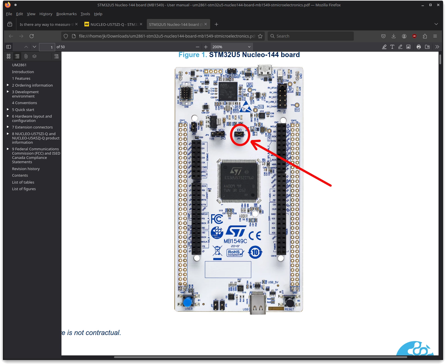

Not possible for you to measure the current from the MCU through jumper JP5 with a DMM?
JP5

‎2024-12-16 2:02 AM
Oh, do you mean that if I connect the DMM across this jumper pins, the job is done? What precision of DMM is required.

@mdalal wrote:Oh, do you mean that if I connect the DMM across this jumper pins, the job is done? What precision of DMM is required.
Yes. The precision of the DMM depends on your requirements. Personally I would prefer a DMM with you can at least measure 1µA.

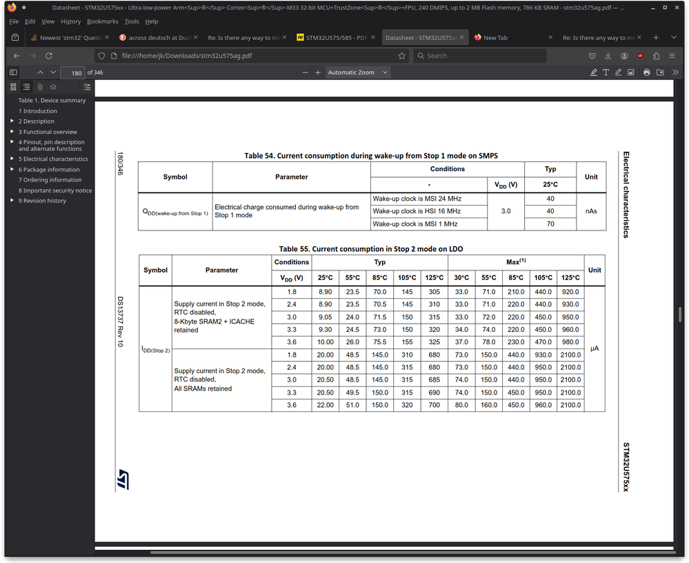

The possible power consumption from the MCU in different situations are also described in the device datasheet. Here is a screenshot:
