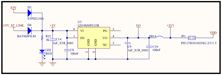

My name is Vincenzo I would like to supply my NUCLEO-F303K8 with an external supply Voltage of +5V.
I prepared a Test Project which control the LED3 to blink with a certain frequency. When I supply the NUCLEO through the VIN pin or through USB connector I see the LED3 blinks, but when I provide +5V through the 5V pin I cannot see the LED3 blinks.
What am I doing wrong?

Also consluting the Electrical Schematic I can see that effectively I provide VDD to the MCU also if I supply the board with +5V pin.

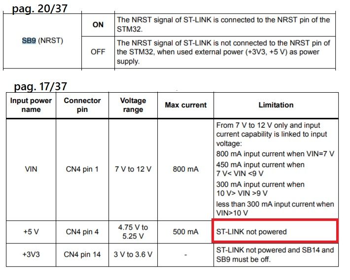

Unpowered ST-LINK pulls down NRST of the connected slave MCU through pin protection diodes. Either power the ST-LINK or disconnect SB9.

Thanks Pirnha, I found confirmation of your solution in the UM 1956 as show in the figure below, but, at the same time, again in the UM 1956, there is a table which says that the SB9 should be removed only in +3v3 supply voltage case.
0693W00000JNAVaQAP.jpgDo you think it's just an oversight?
