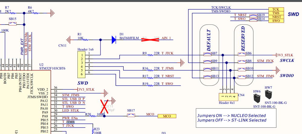

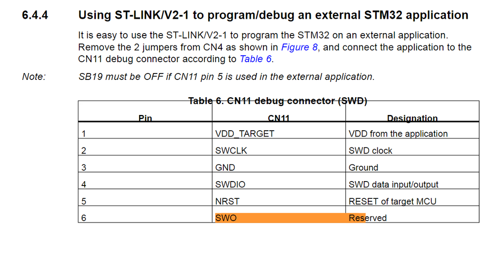

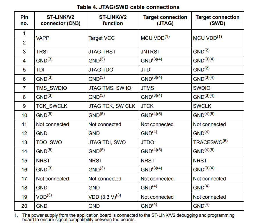

Hey,
I built a project base on the STM32 G070RB Nucleo board.
Now i want to take the cpu and design my own board for a project in my work.
My question is how to connect the STlink v2 to the CPU, because i saw in 3 diffrent resources, diffrent numbers of legs to connect.
  1. PDF schematics - in the upper right corner(4 Legs)
0693W00000Y7AQ9QAN.png2.Datasheet of the board(5 Legs, number 6 is not used!)
0693W00000Y7AQEQA3.png3.Datasheet of the STlink V2(20 Legs)
0693W00000Y7AQJQA3.pngCan any one tell me what is the corrent way ?
App. note "Getting started with STM32G0 Series hardware development" is a recommended reading.
GND, SWDIO, SWCLK are mandatory.
NRST optional if you want to reset the board for debugging
VDD_TARGET/Target VCC optional for detecting/measuring the board voltage/level conversion by the debug probe
SWO additional serial output for logging/tracing, not implemented in G0 series.
hth
