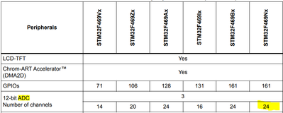

the STM32F469I-DISCO is based on the STM32F469NIH6 MCU wish (according to the DS11189) give you the opportunity to use 24 ADC channel on the same time:
If you are looking for more ADC channels, you can even look for another MCU that support more channels (ST-MCU-FINDER-PC may help you). Or you can use an external ADC to SPI converter that add some ADC channels throw SPI interface.

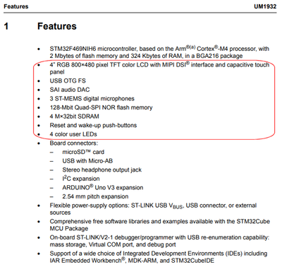

That's the trouble with a development board like that - which has a loads of accessories bolted on:
All of those things use up processor pins - meaning they're not free for you to use for other things.
If you want maximum unobstructed access to as many of the chip's pins as possible, you want a dev board with as few "extras" as possible.

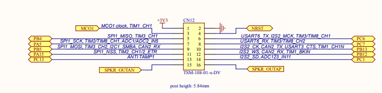

STM32F469I-DISCO has some ADC inputs on connectors, you can use:
So you have : 6 x adc in on CN8 , some (4x) on CN5+7 :  PA1/2/6/7 , (2x) on CN12 : PA5 , PC1 ; 12x i found.
maybe more, just look in ds pinouts for all pins on the headers.

Here it is the ds and the rm , about 1800 pages, and the board circuit diagram .
In circuit diagram you see, what pins you could use to connect ,

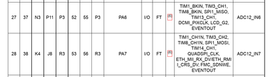

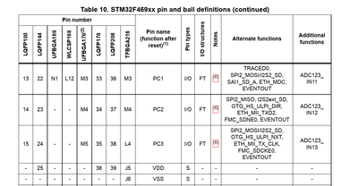

and in ds look in pin definitions, whats on these pins: looking for ADC inputs you see, they are on some group of pins:
So  PA1/2/6/7 can be switched to adc inputs ...
