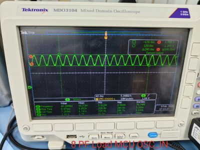

Hi TDK,
Crystal having 8 pF load capacitance, added 8 pF capacitor at both pins and getting same result as without load capacitance.
Do need to check with other value of load capacitance?
Attaching snap for your reference.
Thanks..
chand_p
Hi
Find attached snap, ignore previous one..
Thanks,
I imagine the capacitance of your scope is distorting things as well.
Just because it works doesn't mean it will continue to do so. Follow the recommendations to have the best chance of success. A little surprised it's working at all without any load caps.
Don't mix up specifications for the external clock input with specifications for the external crystal.

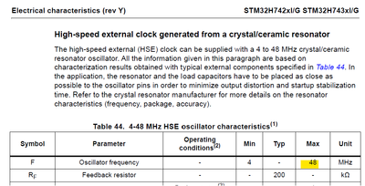

Hi TDK,
We kept Load Capacitance Open due to STM32 10pF Load capacitance.
STM32 Capacitance matching Load capacitance requirement for crystal.
Thanks,
Where are you getting this from?
The required load caps on a CL=8pF crystal should be about 2 * 8 pF - 6 pF = 10pF.
chand_p
Hi TDK,
Referring to attached snap considering STM32 10pF load capacitance.
Thanks,
