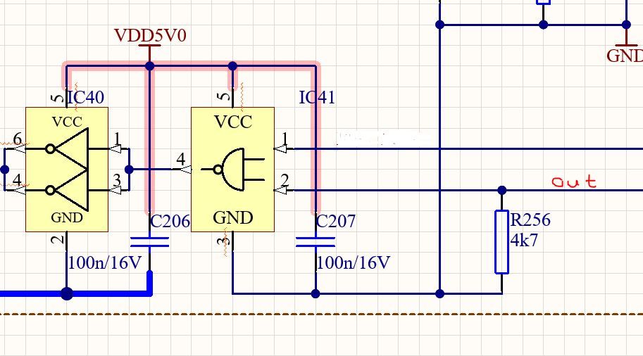

What else is connected there?
I see the same behavior if nothing is connected to the output pins
